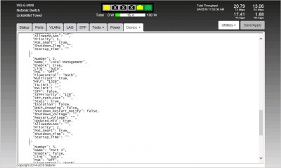

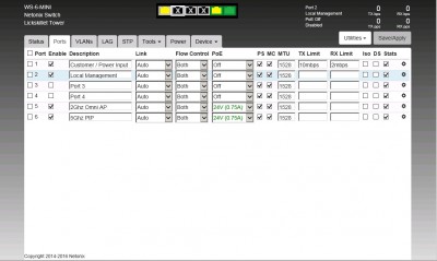

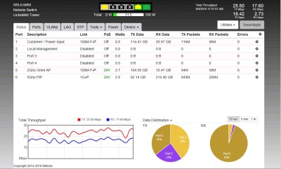

I'm attempting to "enable" port 2 on this switch, I can't get the web gui display to show it is enabled.
I've enabled the port on the port page, and confirmed that the port is enabled in the configuration via the console "show status" command.
However, I can not get an Ethernet link. The GUI still shows it's disabled.

1) What firmware version are you running?
2) Did you modify the config file manually?
If the port does not belong to a VLAN then it is disabled, check your VLANs, the port needs to belong to at least one VLAN

1.4.3rc7
no modifications to the config file manually.
It was the VLAN issue, its good now. Thanks!
