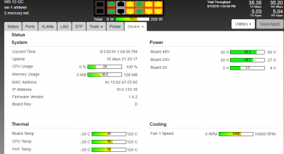

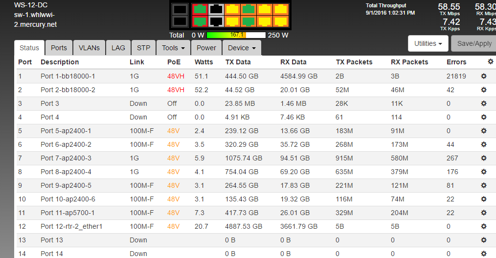

Please post up a screen grab of the main Status Tab showing all the devices powered, I want to see all the port POE options and wattage draw.

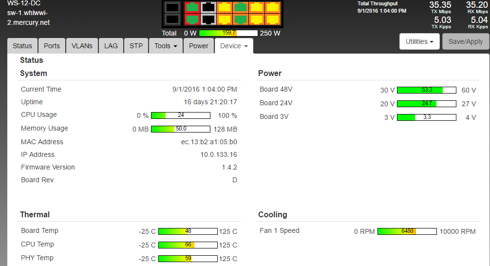

Also the Device/Status Tab

In regard to turning off poe on each port and starting one at a time. We just unplugged all devices as we were onsite at the time, turning up one device at a time does not cause the switch to reboot. I realize this not exactly what you were asking for but this is a large site so taking it down to test is not really feasible. If this occurs again I will certainly keep that in mind. The switch is powered by an Alpha Cordex CXC. The power for the switch is wired to the 48V power port of the Alpha Cordex. Wire size is 12AWG. There is a 5amp fuse on the port and that has not been blown.
Below are the screenshots

Missed a screenshot so here you go

So anyway I wanted to see your status page to see how much 24V load you had which is basically nothing. The reason I wanted to know this is we down convert the 48V input 24V which is then down converted to 3.5 and so on to 1.5V which runs the SOC. Had I see a lot of 24V POE I would have thought it "possible" the 48V to 24V power supply on the switch board could be weak or bad but this in not the case. Also we want to take note that the 48V to 24V power supply will actually function down below 30V and still provide 24V and thus 3.3 and so on.
I also wanted to see your main Stats Tab to make sure the switch had not taken any previous damage which will often show up as a bad current sensor and the wattage on POE ports would be 0 or way off and this is also not the case so the current sensors are all good so no damage there.
As well all the voltage sensors are fine.
