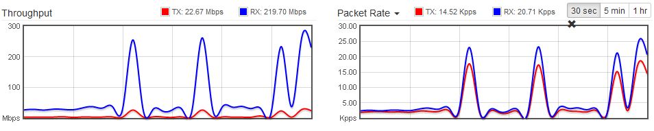

Hello All - I noticed today that one of my WS-12-250-DC switches was showing some abnormal data throughput on the GUI. When I check the UBNT backhaul radio and sectors attached, I dont see the traffic that the Nextonix GUI is reporting.
Netonix: 1.3.9 on WS-12-250-DC
Abnormal Throughput on GUI

Please upgrade top latest firmware and see if problem persists.
Current recommended firmware is v1.4.3rc7 as v1.4.2 has bugs that have been fixed in v1.4.3rc7
