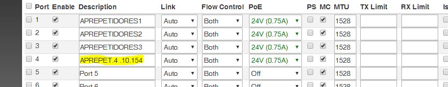

I have recently upgraded to firmware 1.4.2 one WS-12-250AC, and after update I change the description of one port, using dots (.) in it.

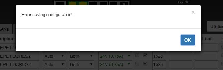

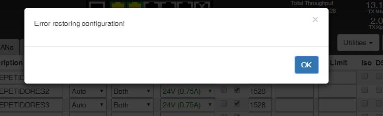

After this change I'm unable to change any parameter of the configuration. Always an error is returned. Restore config and/or downgrade neither works properly.

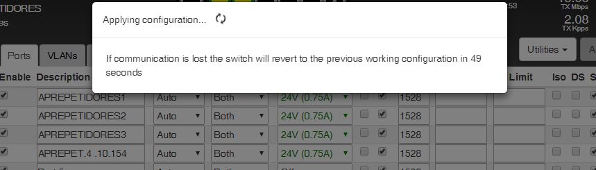

Always after 60 secs. countdown...
Or restoring
