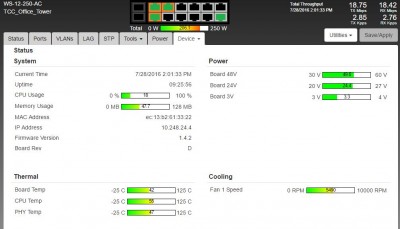

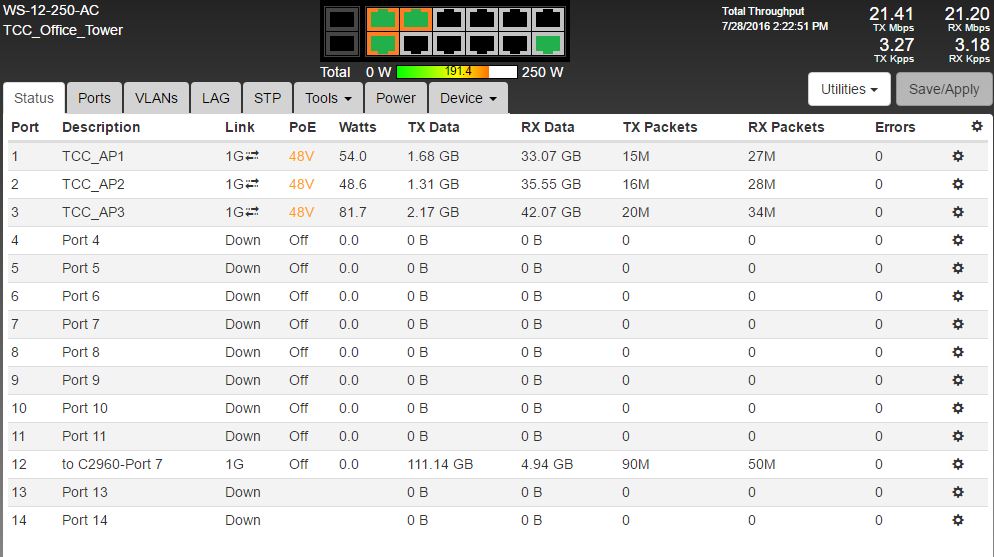

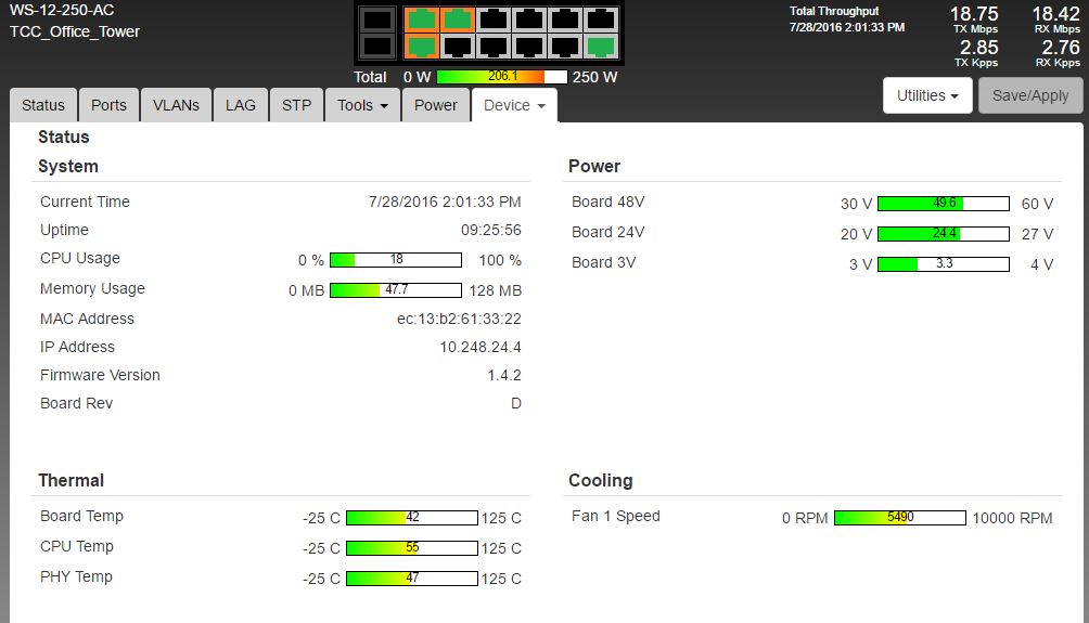

Hello, I have a WS-12-250-AC with three Ubiquiti M5-Ti Rockets attached. The switch is reporting around 200 W being used. I've updated the firmware on the switch to 1.4.2 and the Rockets have updated firmware as well. Ideas? The rockets report to be using 53.4, 49.9, and 81.4 Watts. I doubt that is actual.

Please post up a screen grab of the Status Tab and the Device/Status Tab.

I can't seem to get a screen capture to paste into the response...

My "guess" is that the Current Sensors have taken damage.
Since you posted the screenshot of the Status Tab and I know the MAC if you want to go ahead and pull the switch from service and replace with a spare.

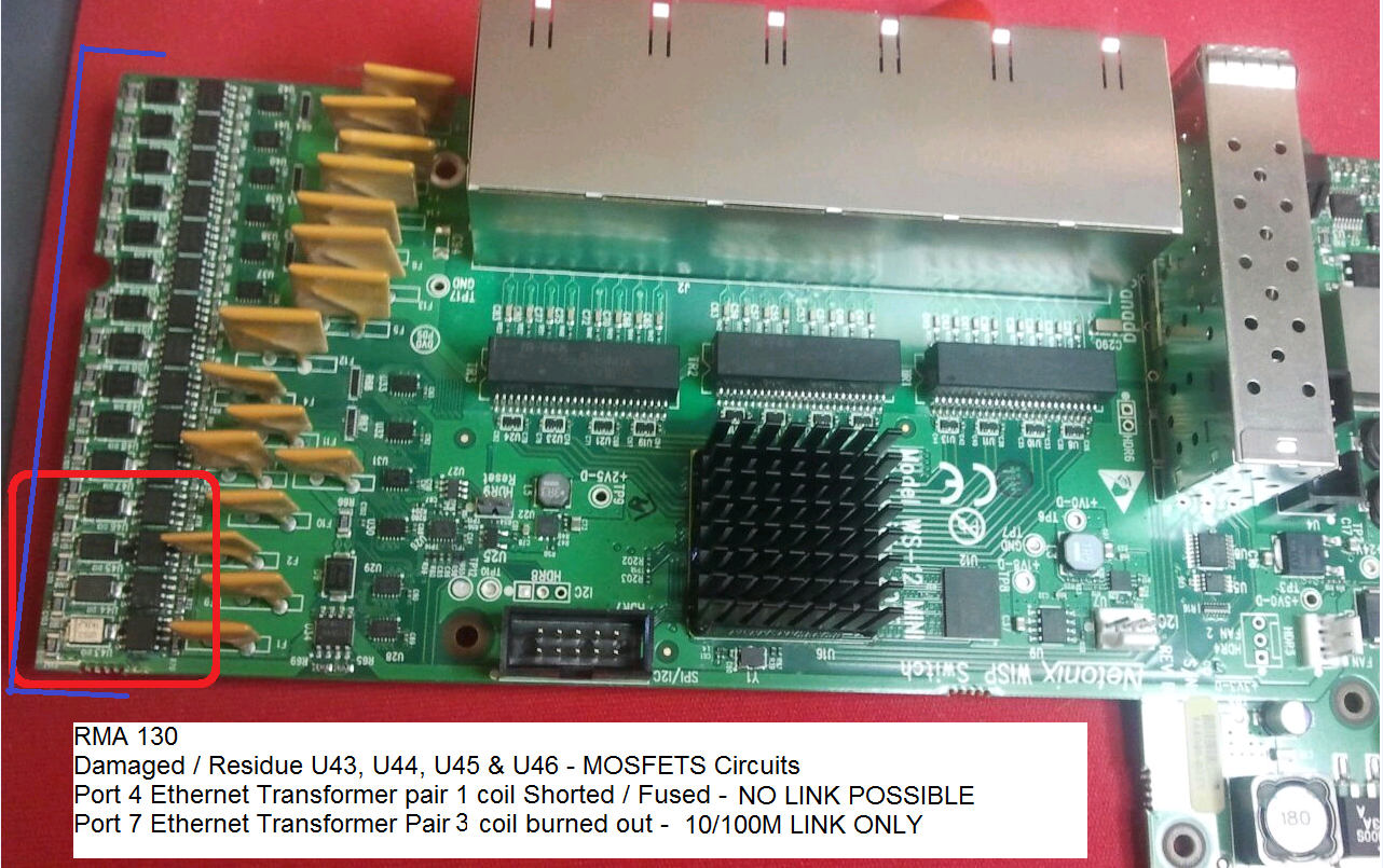

Then open it up.
Then remove the switch board
Then take a picture of top and bottom of board with decent resolution and post here.
My guess is you will see damage either on the top or bottom of the board in the area bracketed in blue in the picture below from another RMA.
Now it will continue to operate like this just the current sensors are damaged and will never report proper wattage.
Typical reason for this is either a surge which exposed the current sensors to a voltage greater than 80V or ground potential shift/differential between your tower and your equipment box. Ground potential shift is the most common reason. Make sure tower ground is bonded to service ground. Have a dedicated ground run to all equipment that is less resistive and shorter path to ground than your Ethernet cables.

Thank you. The switch is in a remote location. I'll be traveling out there next week and will replace this with a spare. I'll also double check the grounding. I appreciate your assistance.
Re: Very High Wattage Reported
Even if damaged the repair cost is only $150.00
Your options would be to RMA it where you pay shipping both ways or simply purchase the replacement board and save the shipping.
