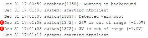

New-just-out-of-the-box WS-12-250-DC switch w/ v1.3.8 (purchased from a distributor) shows board voltage reading errors. No POE enabled on any port.
Tried upgrading to v.1.3.9 with no change....factory reset with no change...downgrade to v1.3.8 and still no change.

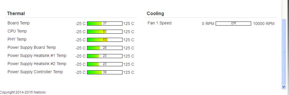

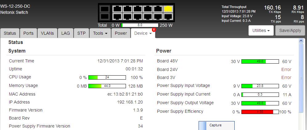

weird...can you post a screen shot of entire status page?

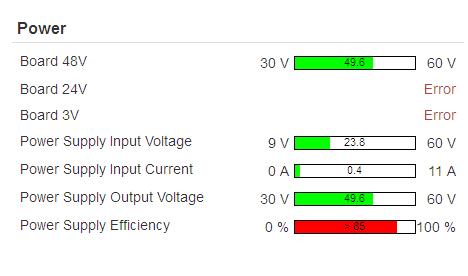

Also noticed the Power Supply Efficiency bar is showing red and >85%. Other WS-12-250-DC switches in production with the same voltage input of 23.8v show efficiency at >92% in the green.
Re: WS-12-250-DC Board Voltage errors
Sat Feb 27, 2016 7:00 pm
RMA it back for us to examine: viewtopic.php?f=6&t=1259
