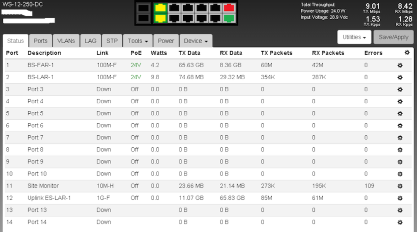

Some screen shots of the first installed WS-12-250-DC
WS-12-250-DC Status Tab
WS-12-250-DC Status Tab.png (122.06 KiB) Viewed 18149 times

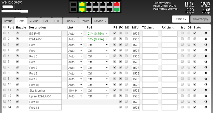

WS-12-250-DC Port Tab
WS-12-250-DC Port Tab.png (142.31 KiB) Viewed 18149 times

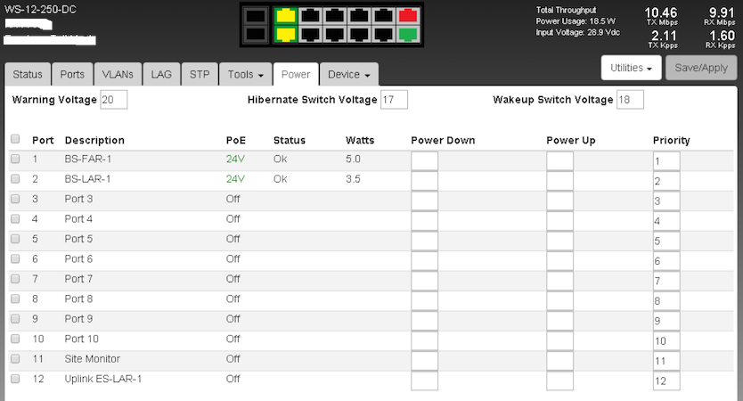

WS-12-250-DC Power Tab
WS-12-250-DC Power Tab.png (98.63 KiB) Viewed 18149 times

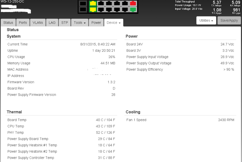

WS-12-250-DC Device Tab
WS-12-250-DC Device Tab.png (119.67 KiB) Viewed 18149 times
