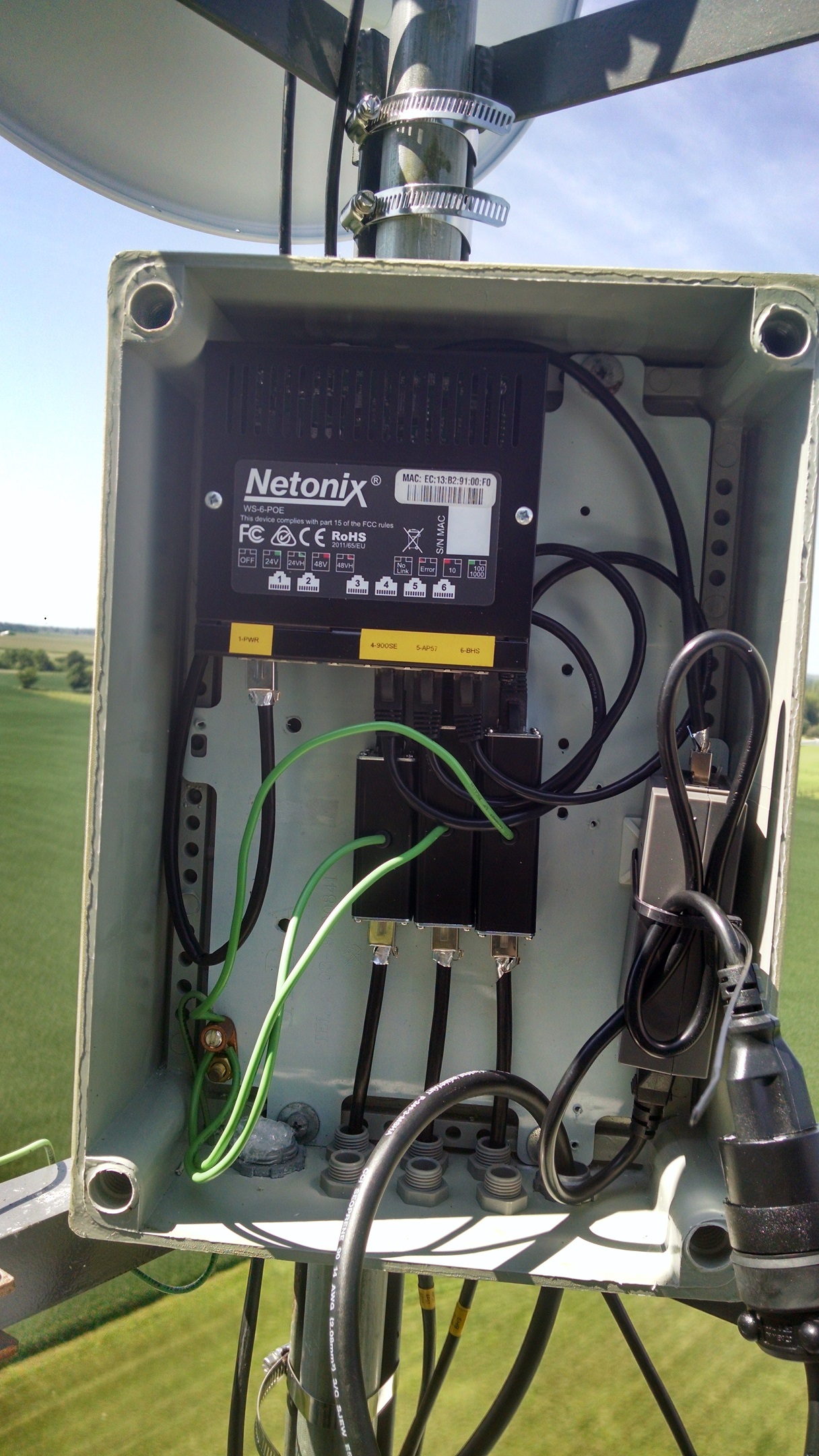

First WS6-Mini install
Posted: Fri Aug 14, 2015 12:25 pm
by sbyrd
I just installed my first WS-Mini switch. This is powering a new UBNT AC tower (my first AC tower). This tower will not be a very big tower for us as the terrain will not allow for probably more than 15-20 clients so I thought I would use this a my first real world test bed for the new Rocket AC.
Anyway this switch is powering a single Rocket AC connected to an Airmax Omni and a Rocket AC PtP connected to a RD-5G30-LW dish with ISO-Beam (sorry Sirhc).

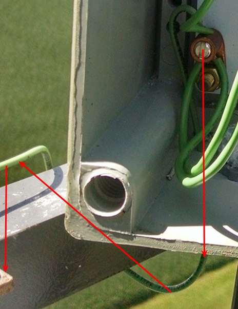

Very nice, but do not forget to use the ground lug on the WS-6-MINI Chassis! :ak:
Re: First WS6-Mini install
Posted: Fri Aug 14, 2015 1:02 pm
by lligetfa
sirhc wrote:Very nice, but do not forget to use the ground lug on the WS-6-MINI Chassis! :ak:
LOL
I was tempted to say the same thing and then decided the two mounting screws are probably doing a better job of grounding to the backboard than that thin green wire.
Posted: Fri Aug 14, 2015 1:06 pm
by lligetfa
Also wonder about disparate grounds between the PoE brick's 3rd prong going through the CAT5 FTP foil ground.
Posted: Fri Aug 14, 2015 4:58 pm
by sbyrd
I will say that the grounding may not be perfect, but I have never had any issue with our other 12 towers. Some are grounded with the separate Tycon arrestors, some with UBNT arrestors, some using just the shielded cat 5. I have never lost any tower equipment to lightning.
Now am I saying that it is grounded the best? No of course it is not, but it is grounded the best I choose to do. Thanks for the suggestions anyway.
