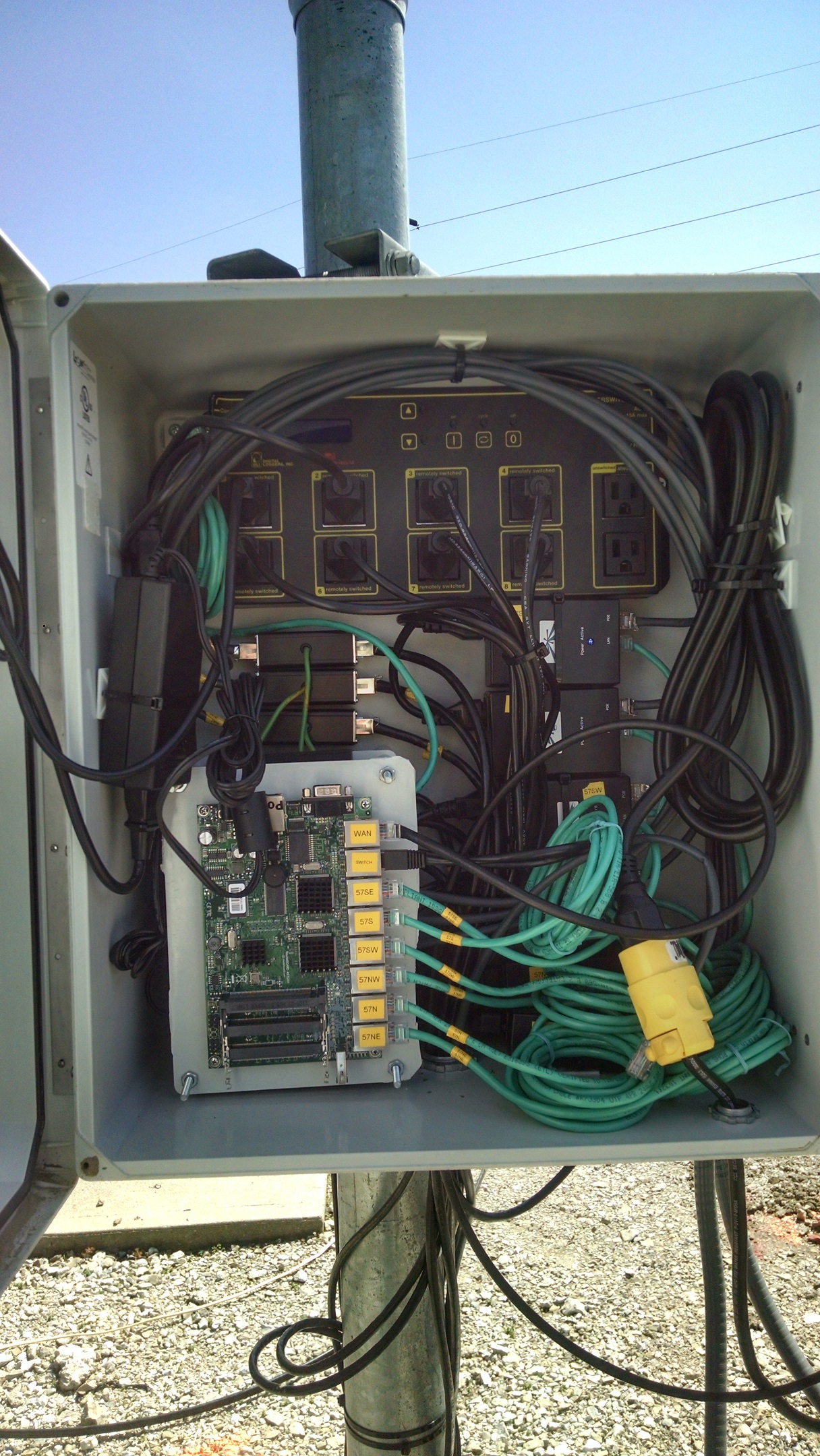

My current box contains:
1 - TS-5
1 - Mikrotik RB493G
9 - Tycon POE Surge Arrestors
1 - Digital Loggers Web Power Switch WPS-IV
6 - UBNT 48V POE injectors
This tower has 6 Rocket Titanium APs and 3 Rocket M2 Aps and has a little over 200 Clients connected.
The plan is to replace the POE injectors with the WS-8-250-AC and the routerboard with a Mikrotik RB850Gx2. I am undecided on if the WPS-IV will remain in place or not. I am currently going to keep the TS-5 right now as I was not able to get a WS-12-250-AC for this project (maybe later).
I will update with more photos once I get the replacement scheduled.

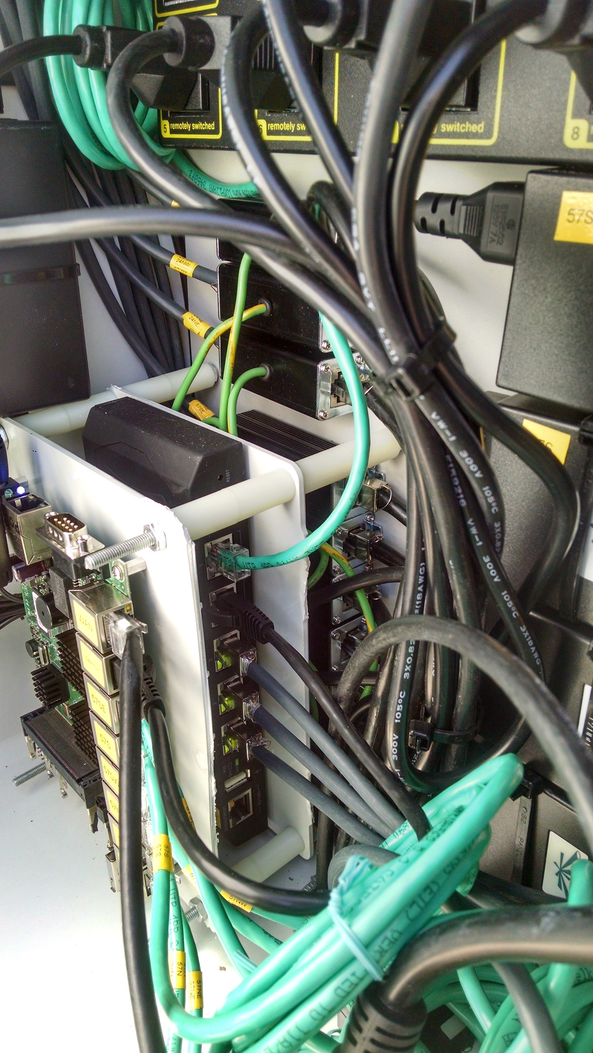

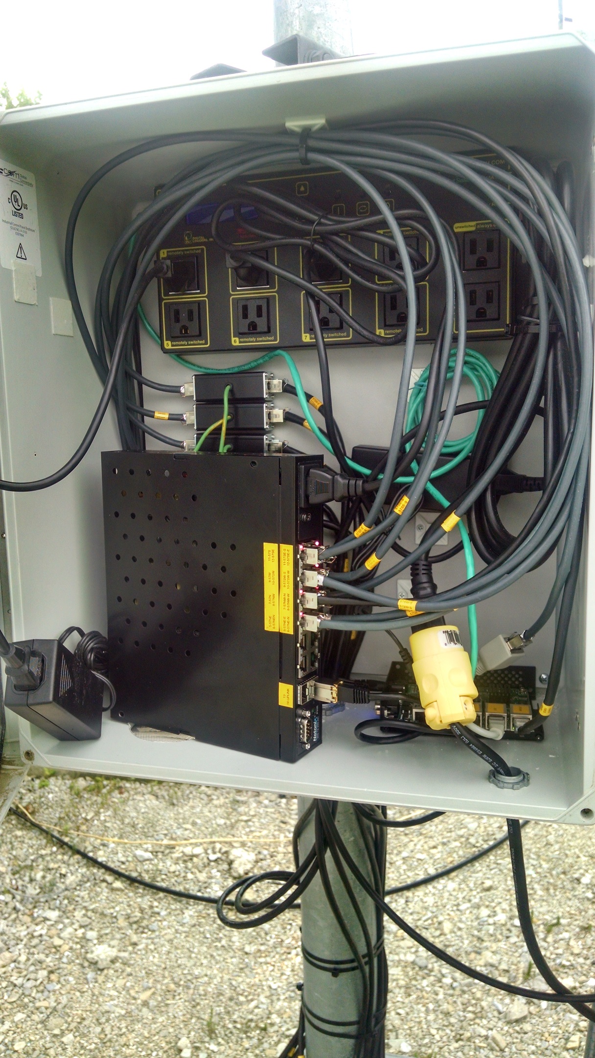

Well I finally got around to putting in the WS-12-250-AC in the box above.
As you can see shoehorning the switch into a box that was setup specifically for the previous equipment, it is not a clean of a look as I would have liked.
However, everything is working great and the extra ports give me room to grow on this tower.
