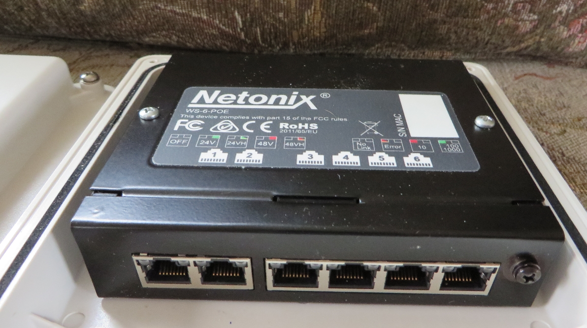

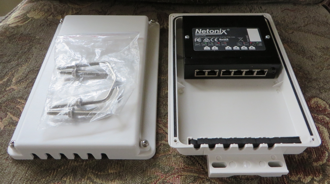

I was thinking about doing an "unboxing" video but then I realized this is an engineering sample so it didn't have a fancy box. Also Dave had mounted it inside a Tycon ENC-SW-8x5 outdoor weatherproof PoE switch enclosure for me. Please note the the WS-6-MINI will not include the enclosure.
Anyway without further ado, here is the unboxed MINI. Tomorrow I will install it and provide more pics and details.

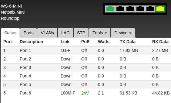

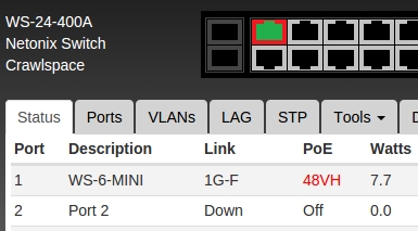

I couldn't wait until tomorrow and so just had to plug it in to test it. I connected it to Port 1 on my WS24 set to 48VH. Note that it is drawing less than 8W and that is with it powering an airCam at 2W.

lligetfa wrote:I couldn't wait until tomorrow and so just had to plug it in to test it. I connected it to Port 1 on my WS24 set to 48VH. Note that it is drawing less than 8W and that is with it powering an airCam at 2W.
I have some micro solar sites that have just 1 48v cam and a NanoBridge. The POE bricks are bridged. With this I could ditch one DC-DC converter, the poe bricks, add another cam and do remote monitoring.
Very excited!
