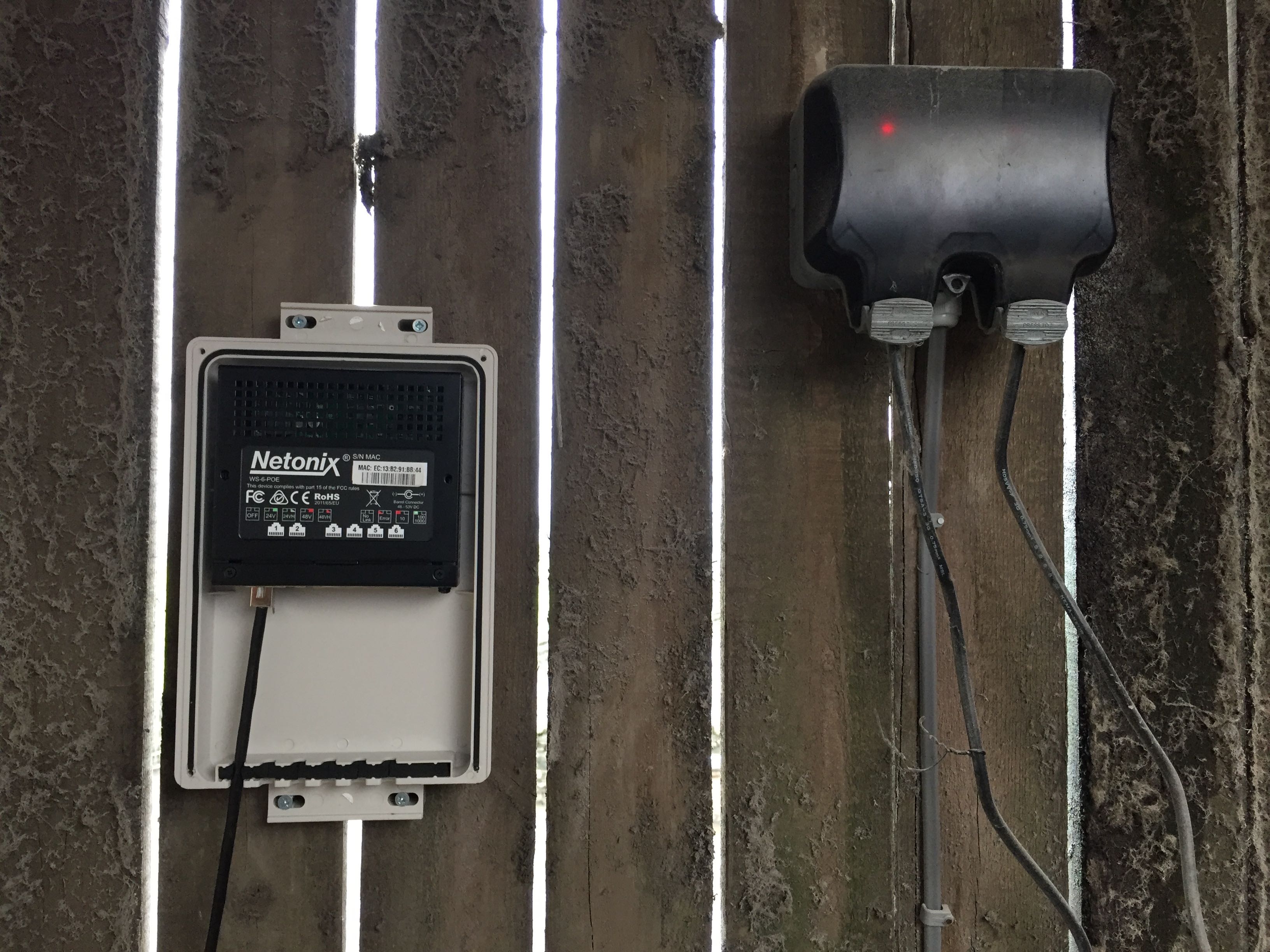

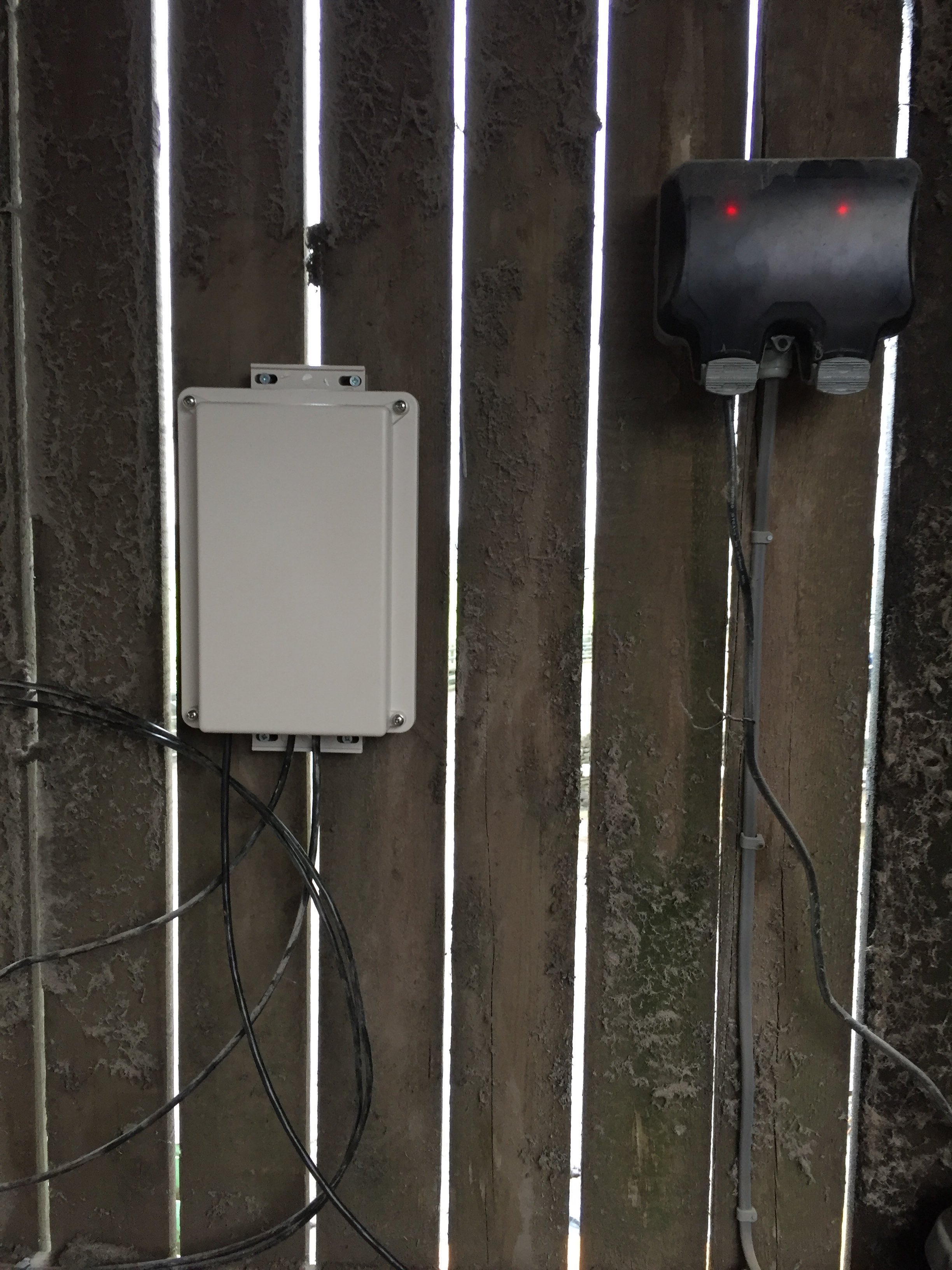

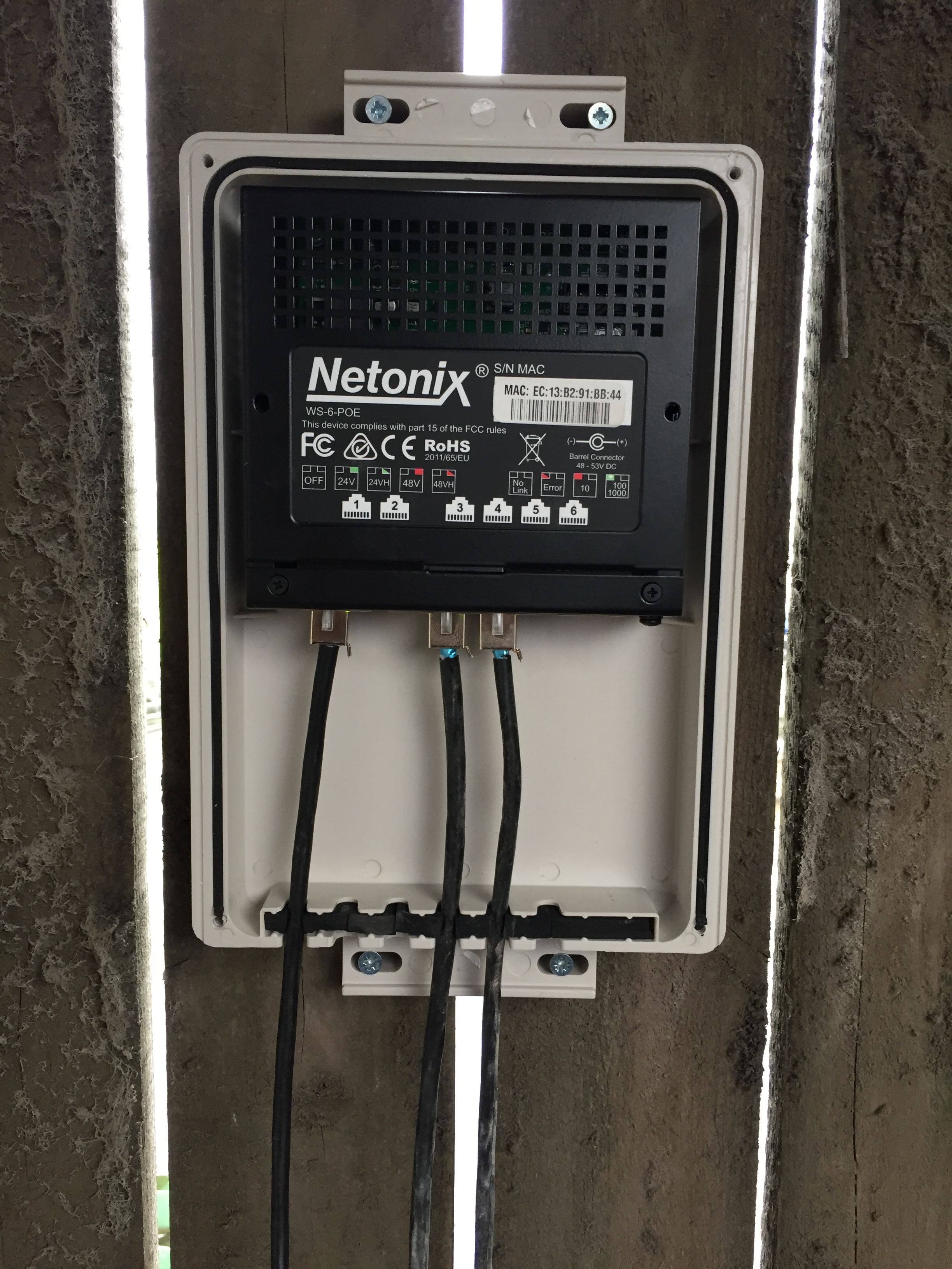

A very simple install for a WS-6-Mini, but posting as I saw you wished more people would post photos.

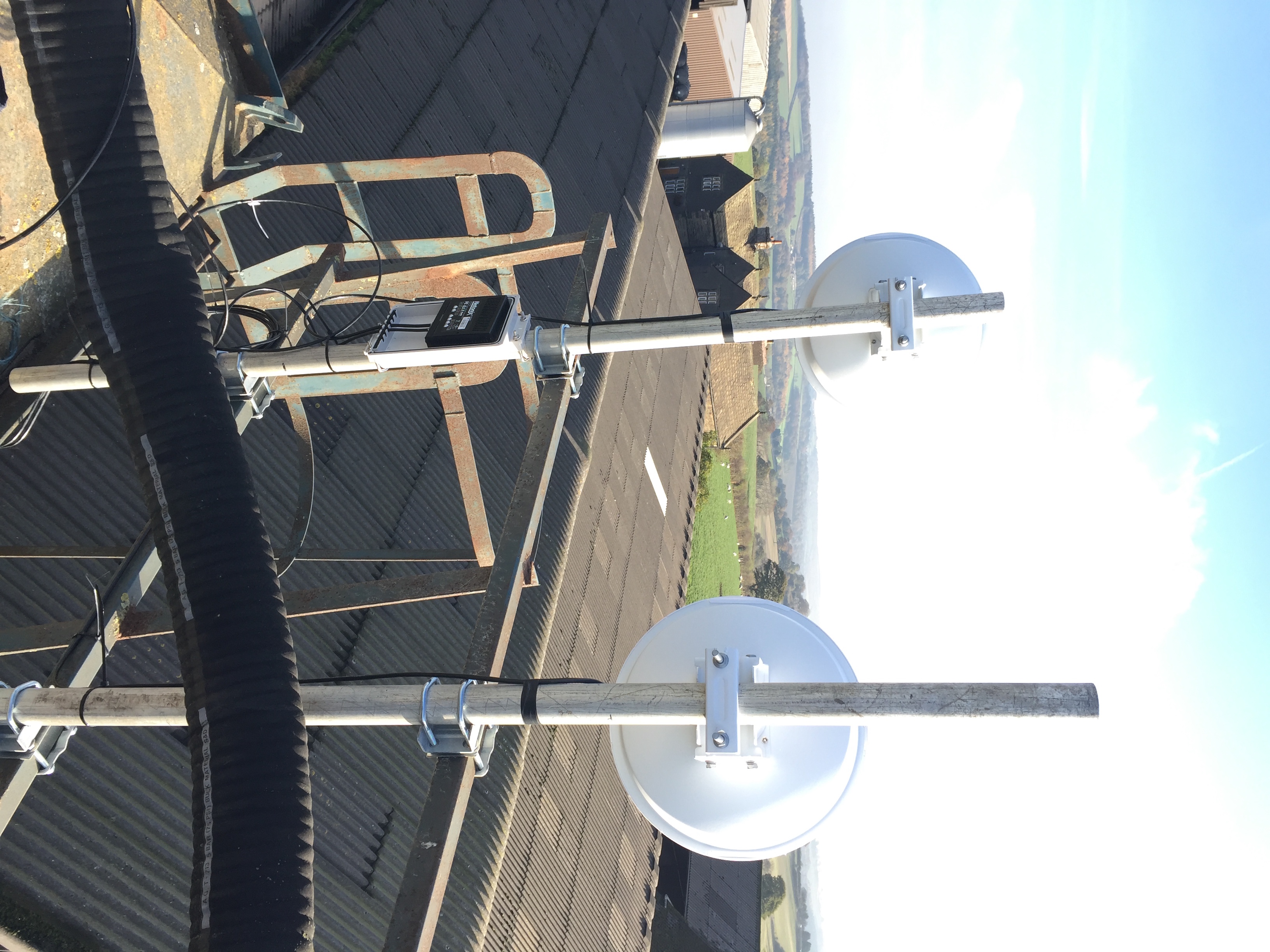

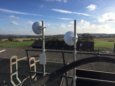

This is a farm based Micro-POP. PowerBeam 5AC-400-ISO in, PowerBeam 5AC-400-ISO out and a NanoStation for the local buildings. WS-6-Mini is powered via Ubnt POE-50-60W, I am close to power here but at other similar sites I have to travel some distance for power and it's nice to have just one spare power supply type rather than mix in the barrel power where it would work. I always think the WS-6 looks super tidy in the designated enclosure, and it's very well protected.

You know I like to mount them by drilling and tapping 8/32 screw holes in the plastic box then use Zinc or Stainless screws to attach the switch in the box.
Double sided tape tends to let loose.

Re: Simple WS-6-Mini deployment
I've been tempted to drill + screw them, really I have. That said, I've had a lot of success with the velcro strips I use (4 rows) and so far, not had any switches come loose.
Nice job Ross! I use automotive number-plate ("license plate"?) double-sided sticky foam tape; cheap as chips on a roll from eBay. That stuff is never coming off. I've noticed recent Mini switches coming with little rubber feet on them though. I have to peel them off before putting the sticky tape on.
sirhc - seems a shame to drill the waterproof Tycon box! Especially when the notches on the Mini just about line up with the little plastic struts in the box - I always wonder whether that's by accident or design!
Glenn - I also always wondered if those slots on the switch were a deliberate move... they are just "too perfect" to be an accident, right?
I started off with the number plate tape too, but on my most recent installs I've been using "super strong velcro" as it allows me to pull the switch out if I need to without having to replace the tape. That said, I've not needed to up until now (famous last words).
I have a couple of WS-Mini's in the Tycon enclosure at the top of a grain stores, close to the radios and they work really well there (mounted directly on the 2inch pole). Then two cable runs to the ground (1 active, 1 spare for those 3am problems) where I have a cabinet, sometimes with a WS-8-150W sending the power (Port1 only), sometimes just with an AirFibre POE brick + AC UPS. For bigger sites, see my newer post, where I am now keeping it DC (and selling my shares in APC).
sirhc wrote:You know I like to mount them by drilling and tapping 8/32 screw holes in the plastic box then use Zinc or Stainless screws to attach the switch in the box.
But thanks for posting.
Does the MINI still use the bottom of the case for a heatsink? I would not want the heatsink to be insulated from the box nor would I want the heat to dry out the adhesive tape.
Yes and no. The ORIGINAL design had an expensive heat sink pad that put the PCB in contact with the chassis and the new design does not but the chassis still wicks heat from the PCB through the posts so having the chassis into contact with the enclosure is a good idea.
