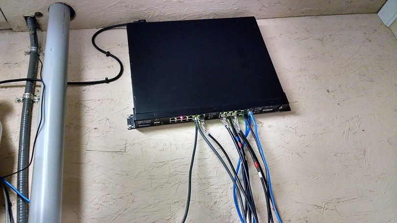

I recieved my new 24 port switch today. Plugged it in an upgraded the FW, smooth as...well, silk I guess. :)
I configured everything, set IP to DHCP and decided to step way out and use untagged vlans. Rookie I am in vlans, I saw tagged, untagged and exclude. hmmm...I don't want tagged, and untagged is if I want to connect 2 ports for backhaul, so the rest must want to be excluded :loud buzzer: I haven't really figured out what exclude is used for...but I don't think you want to use it. All you dark wizards that use CLI would say just whip out the console cable and plug it in (yes, it has a console port) but I'm not like that. I had to reset the device and start over....I might request add a fallback address in case the device does not get one.

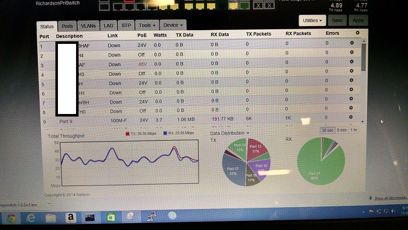

Other than he operator not understanding what exclude means in vlan world, the UI was very intuitive. Being able to see throughput stats is very nice. The removable ears are very nice, and they turn to allow wall mounting....very nice!!
And its quiet...my phone app said its 36 db at about 3 ft.
Switch install...Quiet

Can I interest you in some screen grab software? LOL
When wall mounting like that, you might find that it is tight to get your fingers in to release the cable on the even numbered ports. What I did is put a spacer between the ears and the wall.
Mine is installed on a wall in my crawlspace. Now crawlspace may conjure up images of an uneven dirt floor with rats, snakes, and coons, but mine is actually conditioned space with painted concrete floor and 4 foot high walls that are insulated and drywalled.

lligetfa wrote:Can I interest you in some screen grab software? LOL
lol...it was late...and I was ummm, you know...ummm...partaking in some excellent beverages.
This switch has enough room to get a finger behind it...not a lot, but I really didn't need spacers. Good idea though.
