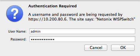

When you initially log into the switch you are presented with a pop-up box, instead of a web based login form... personally I'd prefer a webbased login form... but this is hardly a show stopper: (note the default username is "netonix" not "admin")

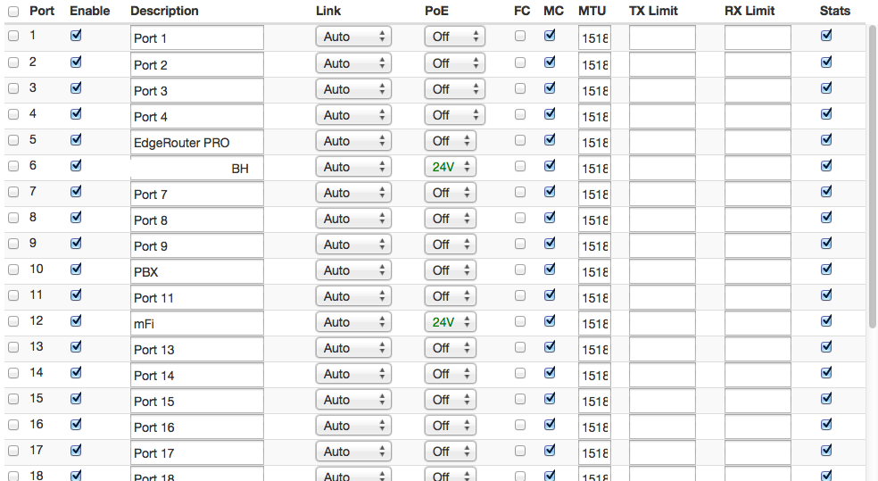

There's nothing super special under the "Ports" tab. Just an easy to configure interface for each port. Checking more than one port reveals a new line item at the very top which can be used to mass configure similar changes on all checked ports. Unchecking a port from the "stats" column will either include or exclude that port from the global TX/RX stats (useful if you only care about seeing a backhaul, or a group of APs):

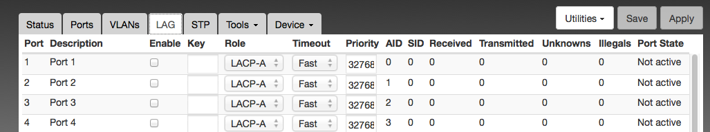

Although I didn't have any application where I could play with it, the switch support LACP/LAG to uplink through two connections which are of similar capacity. Note that it is not recommended to use this on wireless links which may have varying throughput capacities due to RF conditions.

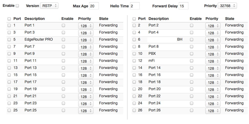

The STP tab is also very straightforward, allowing the end user to configure priorities by port and switch, as well as the type of STP to use:

amishgenius wrote:Awesome!!!
I thought there was a power cycle button for each port....I don't see that
There is, look in the first picture next to the "BH" - port 6, there is a little "recycle icon". Pressing that will power cycle the port.

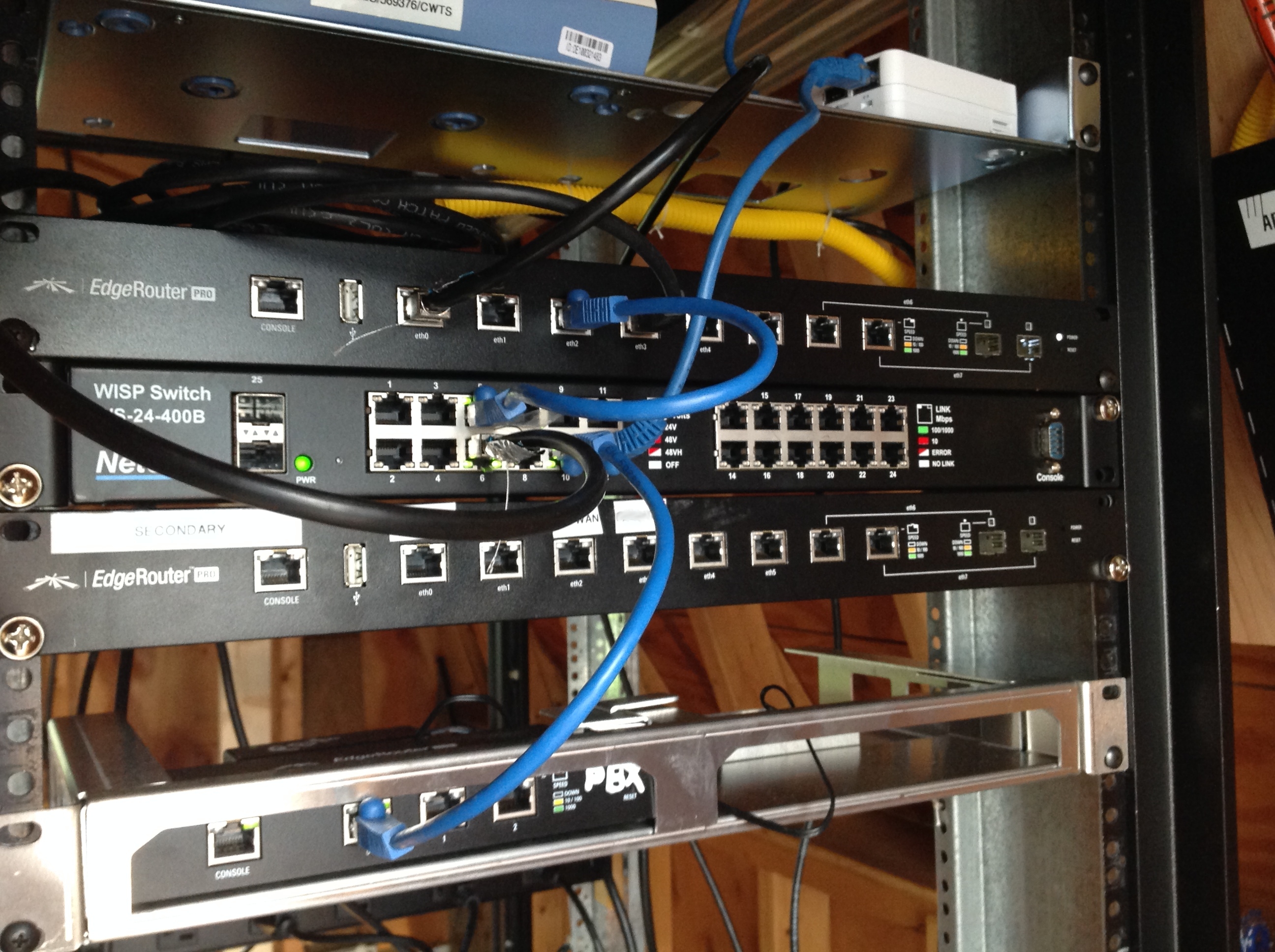

Finally,
A few pictures of the first switch in service. I'll have some more "action shots" of the other switch and an unboxing video later this week.

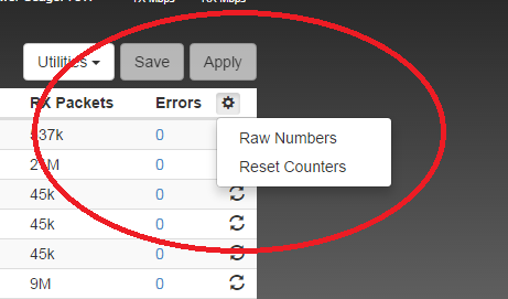

Re: First Look - The Netonix 24 Port WISP SWITCH WS-24-400x
Tue Sep 30, 2014 9:55 am
mhoppes wrote:Initially, there does not appear to be a way to reset counters (such as errors/transmit packets/etc) without bouncing the port. This would be nice to be able to do when troubleshooting issues.
There is a little gear top right corner on status screen above the ports.
mhoppes
Posts: 682
Location: Pennsylvania
Has thanked: 10 times
Been thanked: 125 times
Tue Sep 30, 2014 10:12 am
Ahhh! Thanks, Chris. Then I have a feature request to be able to reset counters on a port by port basis (e.g. I click the "Errors" and up pops the display for that port... I'd like to be able to reset only those counters rather than the entire switch).
