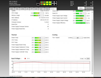

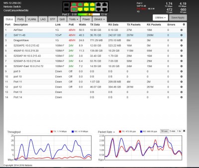

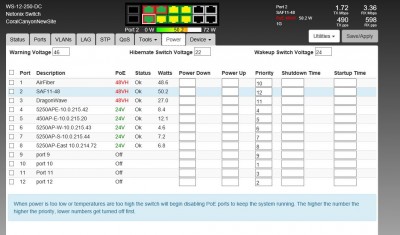

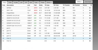

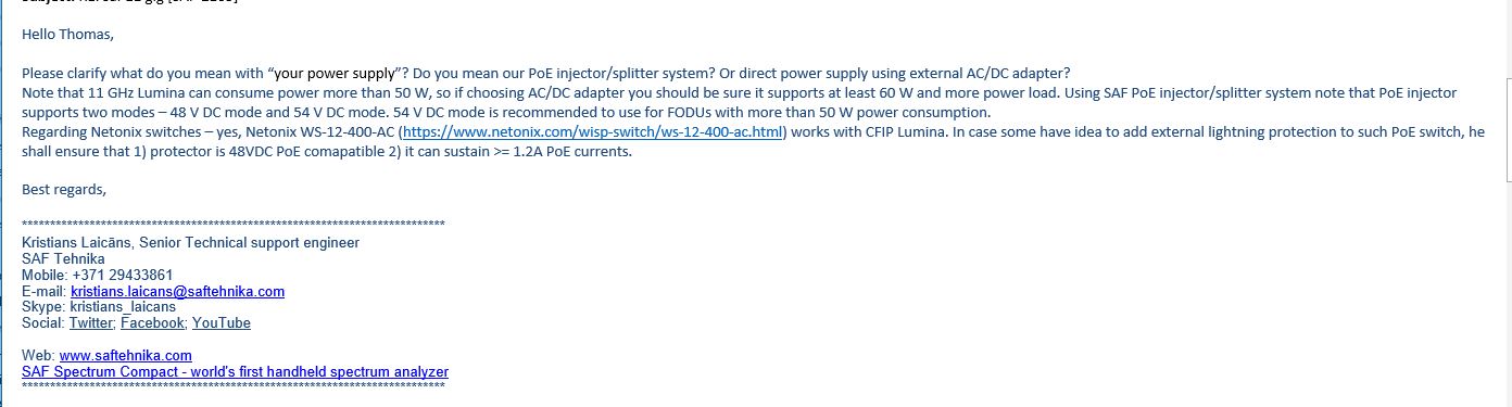

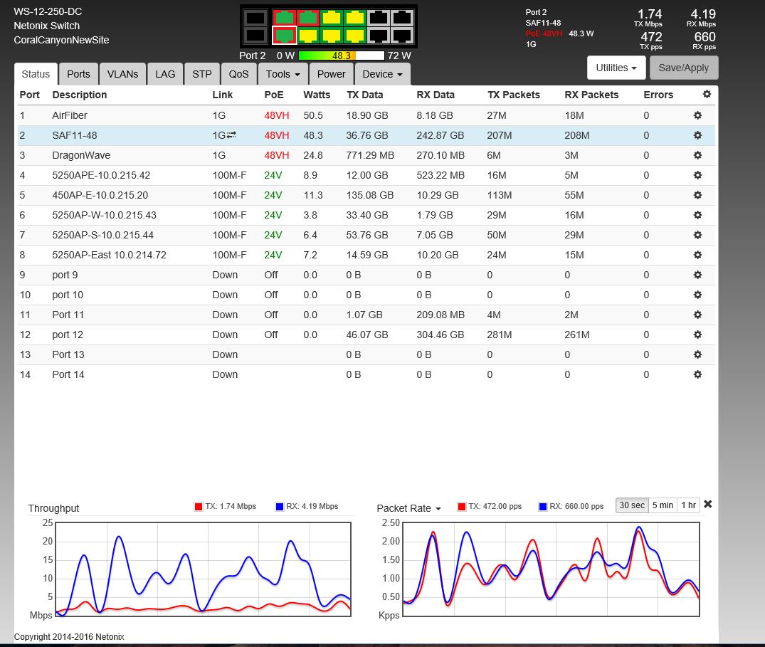

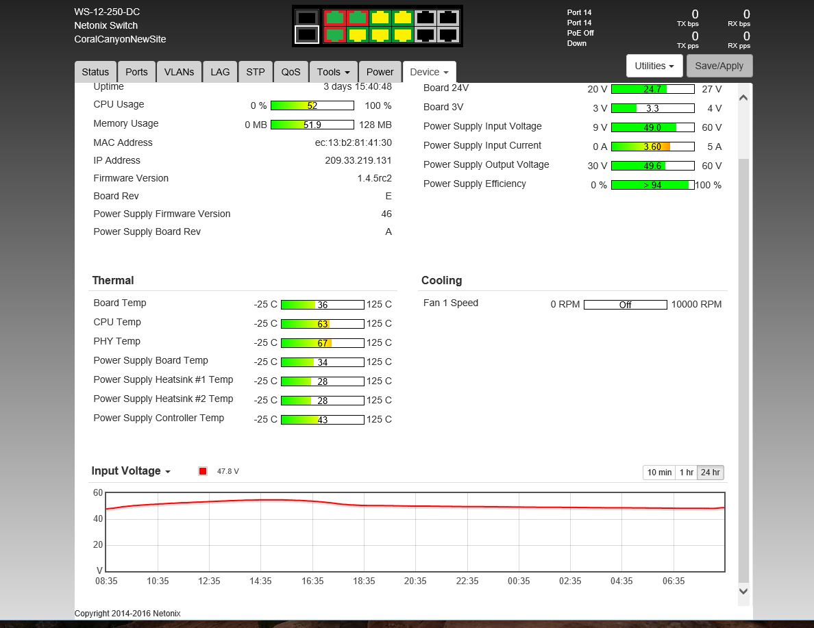

WS-12-250-DC with all different radio combinations.
You sweat profusely plugging in expensive radios without some affirmation that all will be ok,
But these are all in, all powered through the switch,
Airfiber 24
SAF 11 gig
Dragonwave compact 18
Cambium 450AP (with power crossover Cable)
Cambium AP100's (with power crossover cables)

Nice, thanks for posting, and in the right section!
Well I "hope" you plugged them in with POE turned OFF on the ports and then in the UI turned the POE on for each port that way POE Smart could at least catch a shorted cable and not fry the port and or the radio?
Would be nice if you could put up a screen grab that has the header area and maybe also the Device/Status Tab?

Looks great and thanks for the GREAT write up!
When you get a chance I would upgrade to v1.4.5rc8
