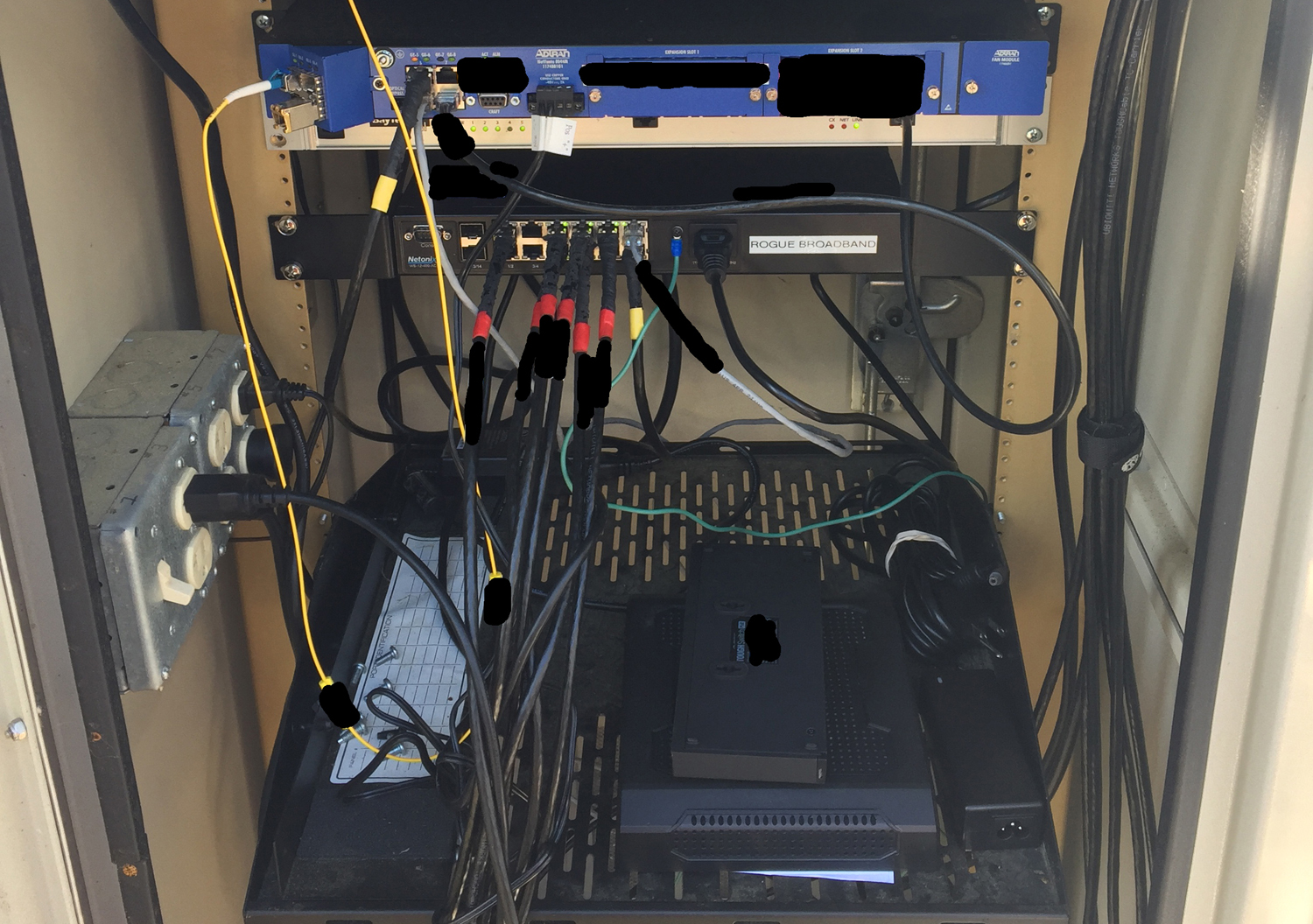

Thank you for the post and the notes. I should be okay using the PA-50V-65W power supply for these jump points. The one I will be changing first has an ISO-400-AC uplink, 3 Rocket M5 units and one client connected port.
The other jump points we have use a single Nanobridge M5 uplink, 1 Rocket M5 and a client connected port. I am not sure I will be changing out the smaller jump points with 1 uplink and 1 Rocket M5 as these will most likely never have enough clients to justify a larger bandwidth push to them.

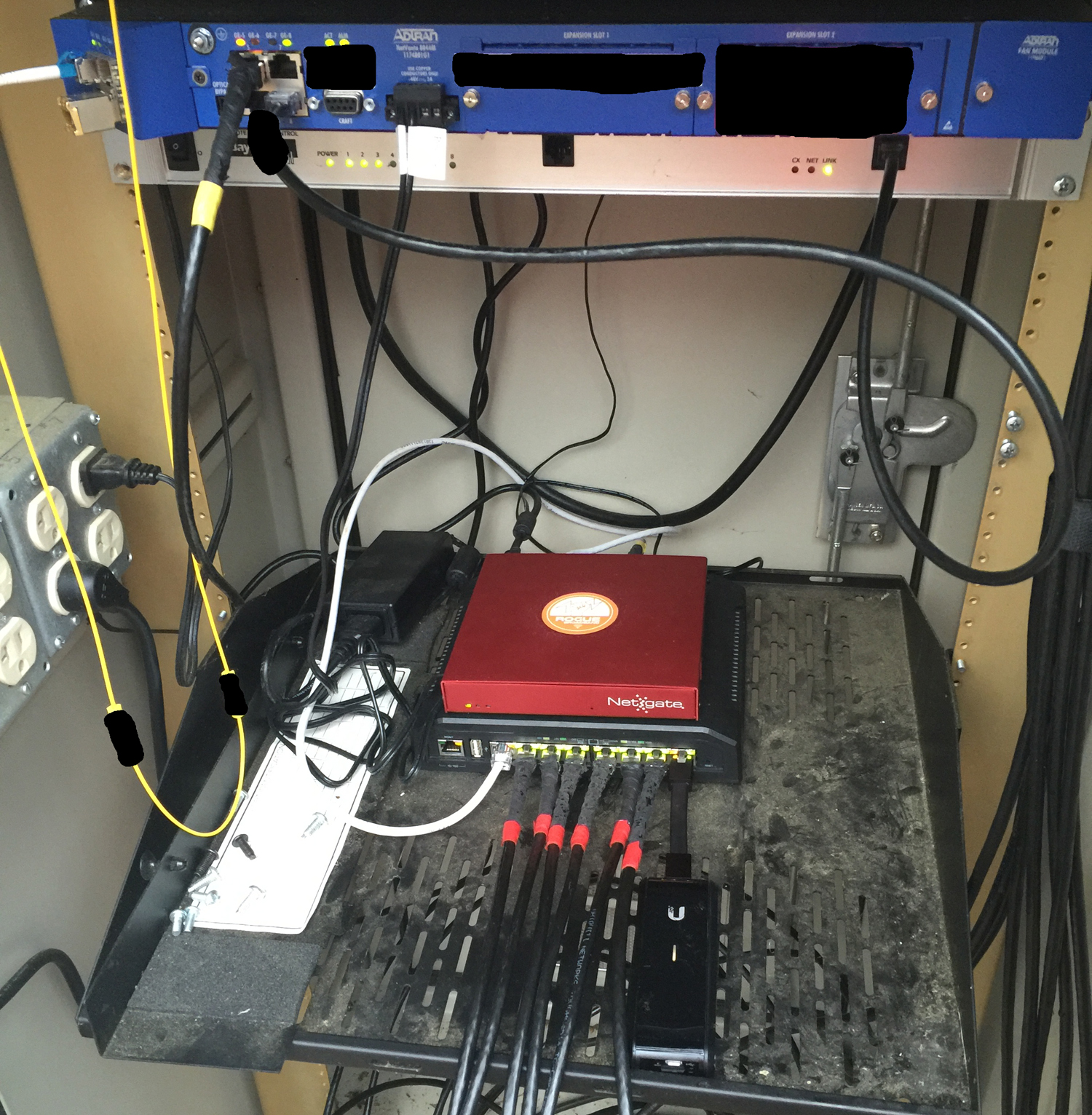

Finally had time to upgrade to the Netonix Switch at this location. I did not have time to do much of any cable maintenance. We will take care of this at a later date. This new Netonix switch actually replaced a TS8 and a cross linked TS5. I just did not have a picture when the TS5 was in the rack. I left the old TS's there just in case I need to roll back for any reason. These will be removed when we go back to do the cable management.
