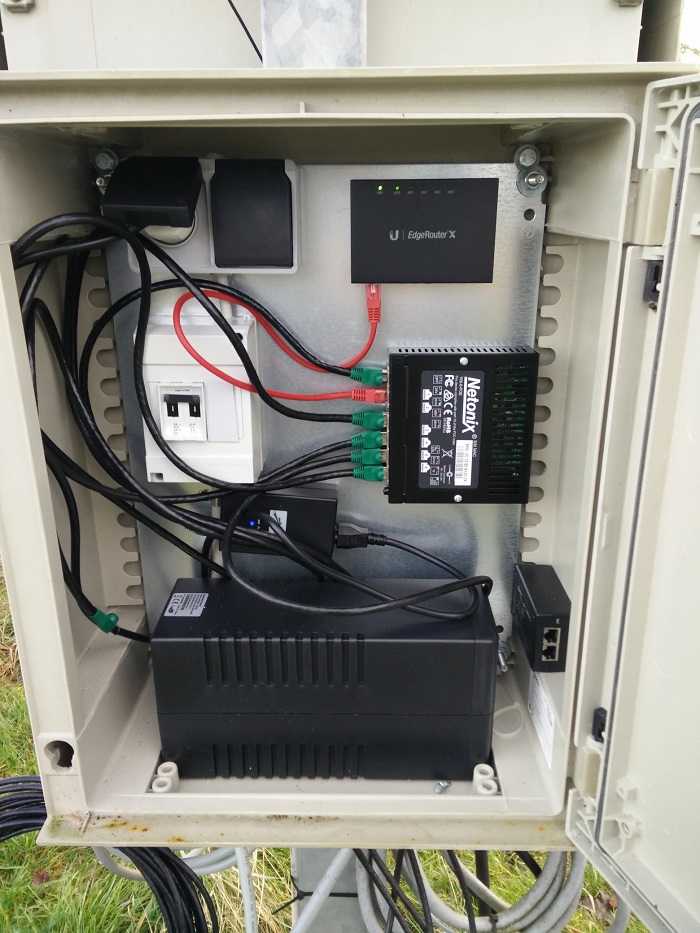

To support only few customers I setup small sites.
Because of the small numbers of customers available the site needs to be cheap.
With the WS-6-MINI that is possible.
To power the WS-6-MINI I use left over AirFiber PoE bricks (I use Netonix switch to power my AF units). The switch then powers PtP link(s) and AP's, but also an EdgeRouter X.
Everything fits nicely together with a small UPS in my Schneider Thalassa PLM enclosure.
I use 24V out port on EdgeRouter to power secondary PtP link if the site needs redundancy.
WS-6-MINI enclosure.jpg (206.06 KiB) Viewed 8672 times
The unused port that powers the switch is used as management port. I connect the computer to the LAN port of the PoE brick and can the manage everything at site.
All sites run OSPF...

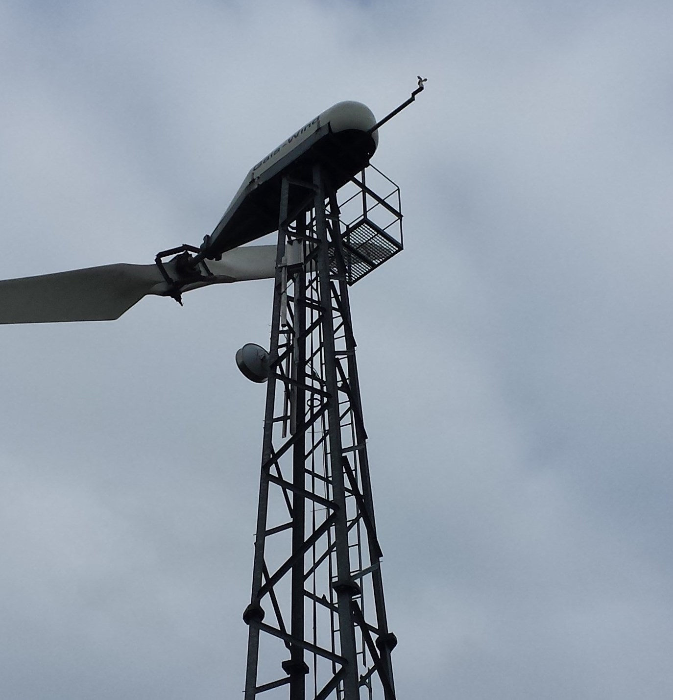

This small site is a windmill installation.
Since picture was taking 2 extra sectors with Rocket AC Lite AP's has been added.
