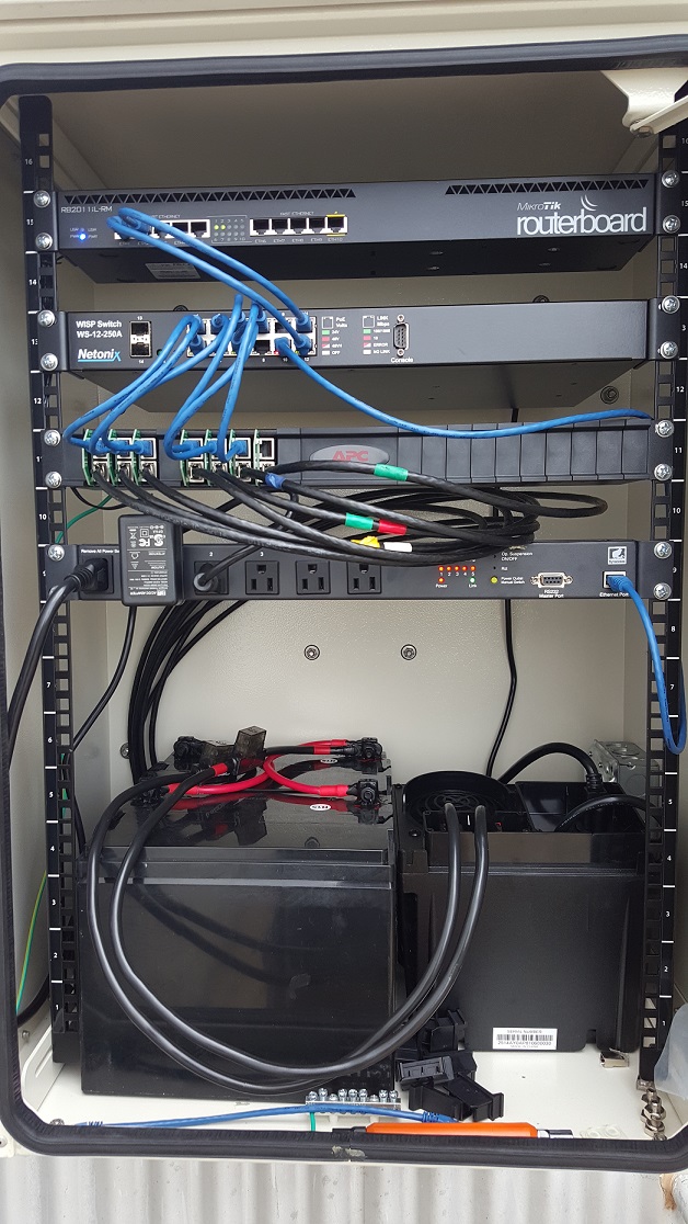

Hi adairw,
what is the model / brand of this rack cabinet?
Pierre

Re: Clean Installs with WISPSwitch #5
It's an American Products Minifort
www.amprod.us
www.amprod.us
I assume the APC device is in-line surge suppression?
Can you share a model number? Works well for you?
The modules are the GIGE-APC-HV http://www.mccowntech.com/rack-mount-gi ... protector/
we buy them from streakwave.
They work quite well.
Hey adairw,
If you dont mind, what is the model of that PDU with ethernet port mgmt?
Nice!! very tidy.
Really interesting the UPS you are using to power all, ¿Why not direct DC for all?
