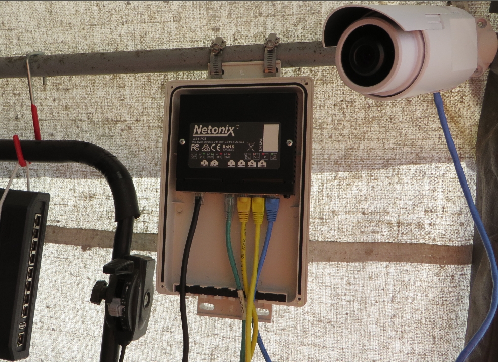

Here are some before and after pics of the TS8 and the MINI. First off, I just want to say that for my use, the TS8 has been stellar, no complaints. In no way do I want to disparage it but as I mentioned in my back story, I needed a solution.
This is how I had the TS8 in the roundtop. The other 3 cams are outside:

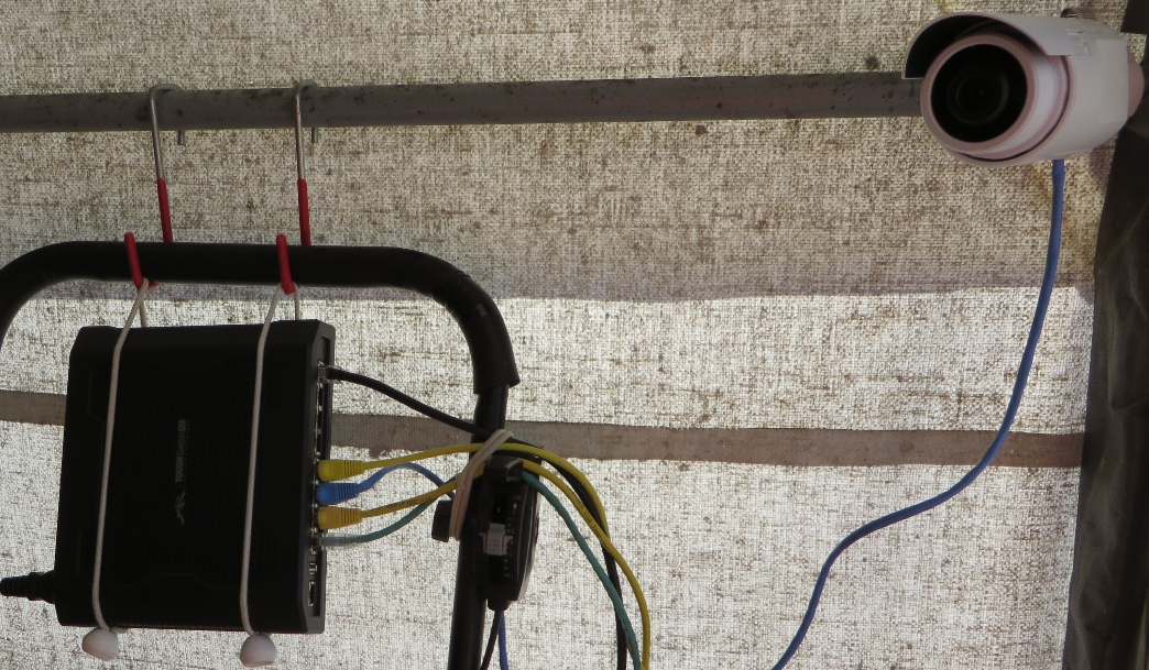

This is the after, cut over to the MINI:

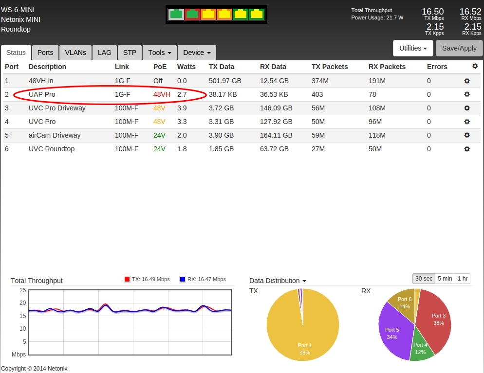

And this is a screenshot of the MINI:

I have been grappling what to do with Port 2 since it puts 24V or 48V on all 8 wires and depending on the device that is connected, I was concerned about shorting it out or defaulting the device. I made enquiries in a couple of threads including http://community.ubnt.com/t5/airMAX-Gen ... 431#M48543 and was told that it most likely wouldn't work for any of the devices I had in mind to use.
Anyway, as seen in that thread, flipper came through for me. I have a UAP Pro connecting and working fine. Pirate4
