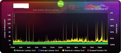

Also the main problem and reason we upgraded this for a WS-12-250-DC is because of performance problems. BIG performance problems.
Some customers were getting the classic 20 Mb down, 60 Mb up issues.
UBNT really need to stop selling Toughswitches. They really are not good switches.
All the customers connecting off the Rocket Ti Sector were getting horrid latency and packet loss. Really horrid. We thought this was the Rocket radio, so swapped a Rocket M5 for a Rocket Ti and no difference.
BEFORE WS-12-250-DC installed and using UBNT TS-5 (You can see when we were changing things over between 7-8pm):
AFTER WS-12-250-DC installed:
