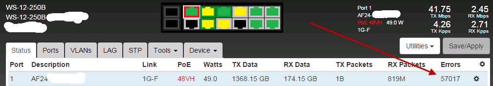

jjonsson wrote:Just found out that I have a lot of errors on port 1 (My AF24 is connected to that port).
Cable has been tested and is tested OK.
Anyone knows why ?
What type of errors?
You can SSH into the airFIBER and type this command in "emacstat"
We had 2 airFIBERS that had bad Ethernet ports and we had to RMA them, but I would try re-crimping the ends and or even re-run the cable if it is not to hard/long.
To eliminate the port in the switch as the problem try a different port preferably at least 2 ports away, if no other 48VH port is available use a non 48VH port and the POE Brick.

Hi Chris,
This is a switch and link in use. Not easy to take out of use for maintenance.
Here's result from AF24:

The TxErroredFrames number of 56930 is equal to that of the switch.

Re: Recommended product! WS-8-250-AC
Tue Mar 03, 2015 7:20 pm
Give me a screenshot of the WS port Stats (click little gear on far right of port line) select Port Details
