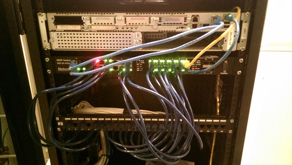

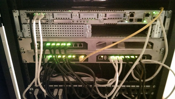

We decided to upgrade one of our towers. There was a need for three 8 port Tough Switches due to the number of access points. Installing a 24 Port Wisp Switch allowed us to clean up the wiring a bit as well as condense the equipment in regards to rack space.
Before
After

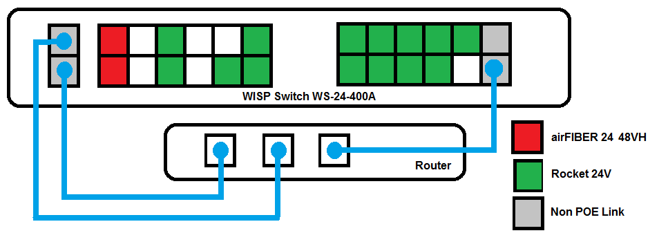

We managed to not only clean things up by not having as many inter-switch connections, but we aggregated three gig ports between the router and switch and used that group as a single trunk carrying all the local Vlans. We were also able to remove the 48v power supplies that we had wire tied to the enclosure, which was honestly the best option I could think of at the time. Overall I think it has a more clean look now than before.

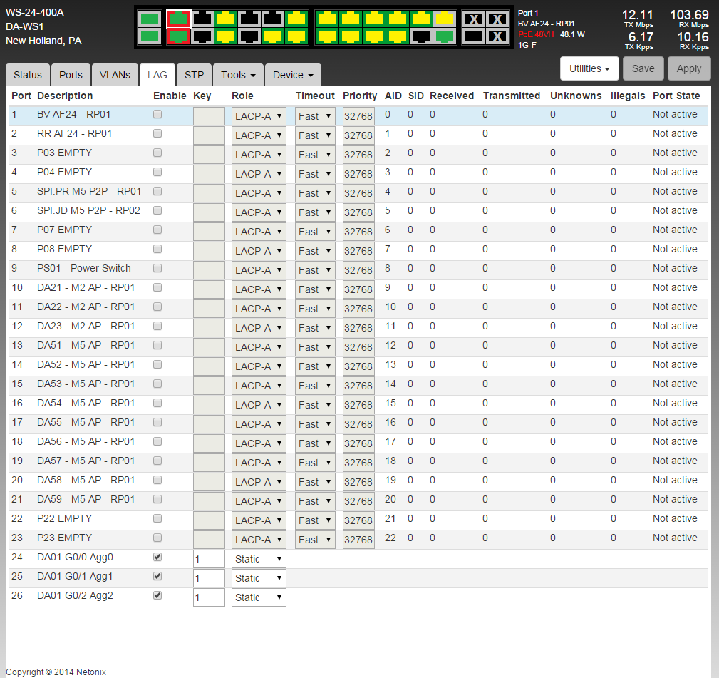

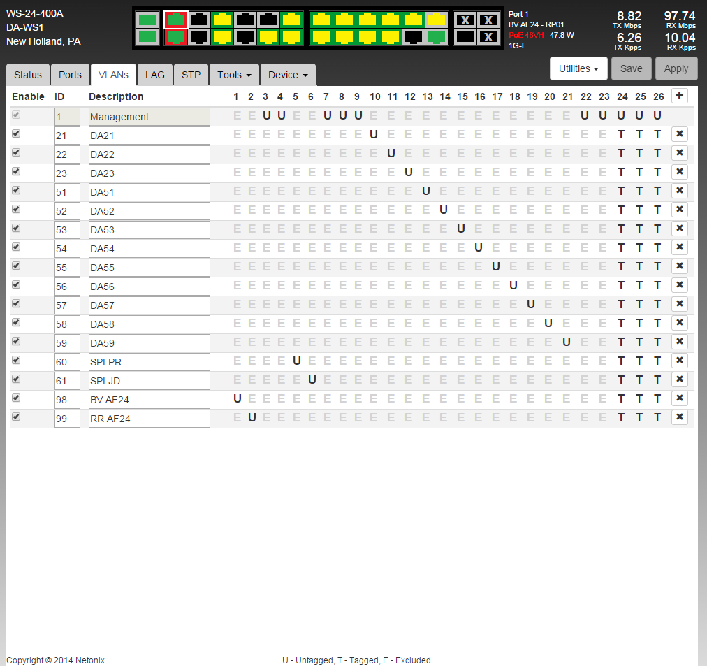

With the WISP Switch you can create a Static aggregation trunk between the router and the switch. In this case
three 1 GB ports are aggregated together to create a 3 GB trunk between the switch and the router.
Then each WISP Switch port basically becomes a virtual interface of the router allowing you to power ALL your radios
from one switch through VLANs.

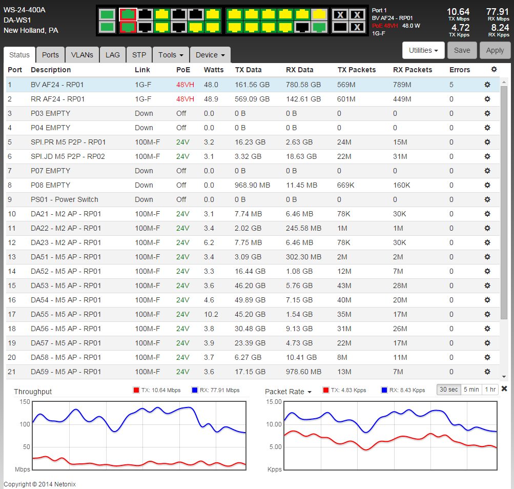

In the pictures below you can see the interface of the WISP Switch and how it is bonded to the router.
You can set up the switch to do your ping watch dog to ALL your radios including your airFIBER radios and auto
power cycle them if needed or you can do it manually with the UI or CLI.
Also on one interface you can if there are any errors on any ports at a glance.

Re: Tower Upgrade
looks awesome. love the setup.
Do you have anyone using LAG to a Mikrotik? Personally never tried it but probably will very soon as I'm testing some different configurations.
- Rory
Re: Tower Upgrade
With the mikrotik you may be able to use LACP as well as static aggregation. In the cisco world you don't see lacp on anything other than switches until you get well above our budget. I would definitely investigate what aggregation methods are available on your platform.
