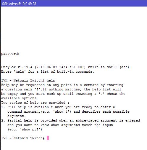

The console/SSH has in line help
login
Press ? then [ENTER]
You get a list of commands available at that point.
So if you login and press "?" and Enter you see available command
You want to configure so you type configure and press Enter
Then press ? and Enter and you see a list of available commands.
You would want IP so if you type IP ? and press Enter you see a list of IP commands.
The entire SSH/Console offers inline help and is modeled after Cisco.
When you are done making changes in configuration you press CTRL+Z to exit configuration mode which saves and applies your changes
