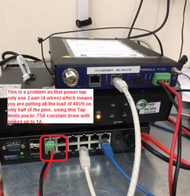

Thanks for your help so far, you can view the spec of the link here, here's how we have everything set up on our test bench:
Battery Setup:
Netonix setup (this is a test power cable instead of the 4pair but it does the same on both)
Voltages on the switch
With an intermediate switch everything works OK
When we connect the lan port for the data to the netonix directly it shuts down and re-boots.
Battery Setup:

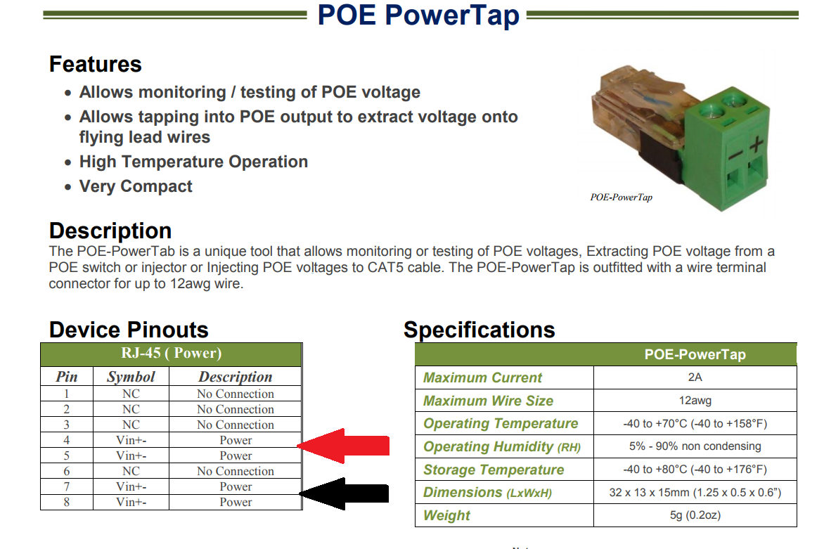

Well first off that power tab is not designed for 48VH as it only uses PINS 4,5 for positive and PINS 7,8 for negative
48VH needs PINs 1,2,4,5 for positive and PINS 3,6,7,8 for negative which spreads the load out over all 8 wires not just 4
It is fine for 48V as it only uses 2 Pair or 4 wires to carry current which is fine for our 48V POE option.
All this is explained in this post as to what each POE option uses as far as PINs and polarity: viewtopic.php?f=6&t=1178#p8809
By using that POE tap of you try and draw more than .75A / 37.5 watts constant or 1A / 50 watts spikes you will damage the Ethernet transformer as the trans former is rated at a MAX of 1A per pair.
