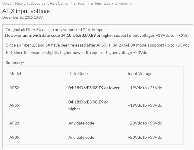

sirhc wrote: We removed the 24VH option as it is no longer needed for AFX radios and too many people thought if 24V made an airMAX radio run good then 24VH would supercharge it
Ubiquiti tells me that you should have 24VH (specifically four pair power) for "longer runs" on AF5x. Should we expect 24V to work at ~300 feet of cat5?
If you read this post: viewtopic.php?f=6&t=1215#p9040
You will learn that all new AFX radios now support up to 48VH so you can power an AFX radio as follows:
24V POE option up to about 160' of cable
24VH POE option up to 326' of cable
48V POE option up to about 250' of cable
48VH POE option up to 326' of cable
So you see we decided to remove the 24VH option on port 2 of the WS-6-MINI to allow more options like being able to power airMAX radios since you can NOT use VH option to power airMAX radios.
Up to Rev E WS-6-MINI Port 2 POE options: 24VH and 48VH which limited it to airFIBER radios and other high power radios ONLY
Rev F WS-6-MINI Port 2 POE options: 24V, 48V, and 48VH which allows many more POE options for more radios.
The only radios on the market now that can use 24VH is AFX and Ignite MetroLink all other radios will burn on 24VH but why use 24VH for AFX radios when you can use 24V,48V, and 48VH. And the MetroLink works fine wit our 24V POE option as reported by many people including me at my WISP.

Right but I am using a DC WispSwitch and it's fed with 24v. I would prefer to stick with 24v in and out to keep efficiency higher and run time longer.
EDIT: Also I have a couple of the earlier MACs that aren't able to do 48v which happen to be on a 255 foot tower, roughly 300 foot cat5. This will absolutely require 24v and 24vh is a much smarter option.

jluthman wrote:Right but I am using a DC WispSwitch and it's fed with 24v. I would prefer to stick with 24v in and out to keep efficiency higher and run time longer.
OK but the logic is the same, you do NOT need 24VH for AFX radios as you can use 24V, 48V, or 48VH
And it does not matter what voltage you feed the WS-8-150-DC it upconverts all voltage to 50V internally as a base line then down converts to 24V as needed.
The same logic is with all our switches AC or DC the power supply outputs 50V to the board then the board either passes that out as 48V or down converts to 24V.
If we used a power supply that had dual voltage output it could cost more to build.
Just like the ToughSWITCH AC power supply outputs 48V then on the switchboard it converts 48V to 24V as needed.
And of course we down convert 50V to 5V, 3.3V, 1.5V, 1V and all the other voltages we need to run the switch.
But your original question was what POE option should I use to power an AFX radio and the answer is 48VH is preferred but 48V would be second choice, and 24V is OK for short cable runs.
I run a WISP as well and I power AFX radios with 24V, 48V, 24VH, and 48VH depending on what ports I have available and the cable length.
