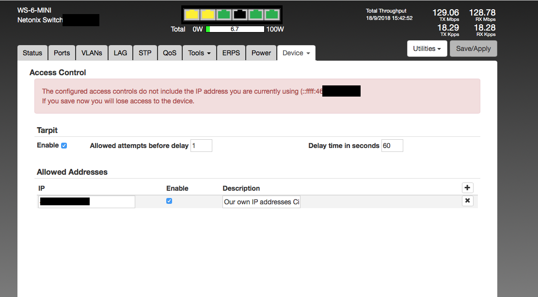

Stephen, strange thing in the access control panel with this firmware. It mentions:
The configured access controls do not include the IP address you are currently using (::ffff:46.**.***.**).
If you save now you will lose access to the device.
I logged out of the switch after upgrade and logged back in and the message is still there.

Post up a screen grab of your Access Control list and what IP are you located at
Re: Strange behavior MINI
Hi Sirhc, screen shot attached. At this moment we have not had the problem since we have upgraded.
I have sent you the IP addresses in a private message.
Well the screen grab above is useless as I needed to see what your IP was and what your IP allowed range was.
Your picture looks more like what the FBI is providing Congress for oversight these days - HEAVILY REDACTED - LOL
I asked Stephen the programmer working on this to reach out to you.

I understand but I also need to see what your Access List of IP's is.
You said your error message was that you would lose control of the switch which is because the IP your at does not fall within the specified allowed IP's in your list....correct?
