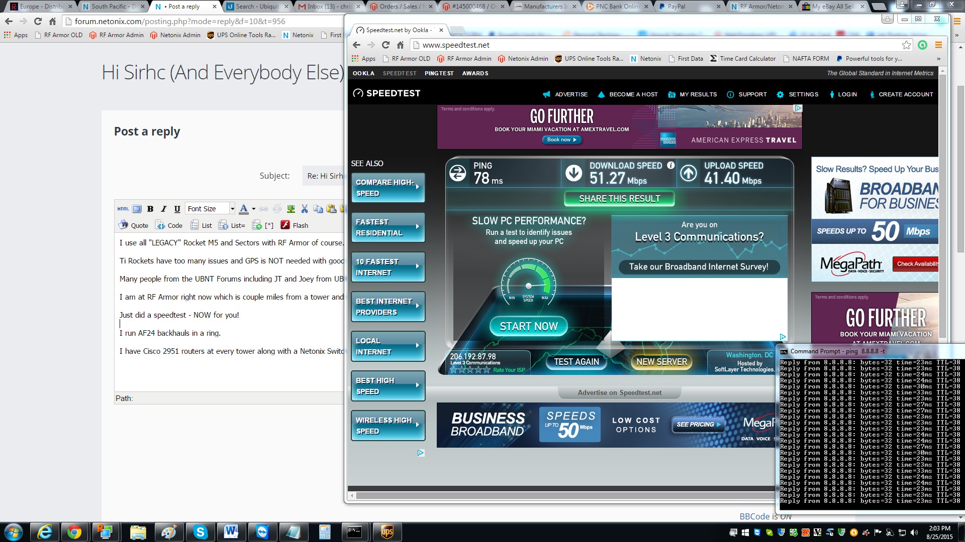

I just did a speedtest for you see below
CLICK IMAGE TO VIEW FULL SIZE
