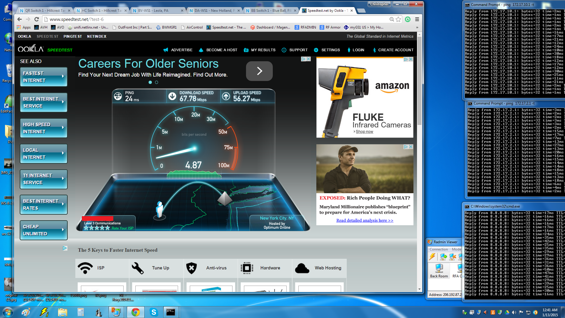

You know I saw a post on the UBNT Forums the other day about ClaudeSS getting excited about 70 Mbps with the new airMAX Rocket AC PTMP with a 20 MHz wide channel.
CORRECTION HE GOT THAT ON 10 MHz AS WELL - which is impressive
http://community.ubnt.com/t5/airMAX-Sto ... -p/1146365
I have been getting close to 70+ Mbps on 20 MHz channels and 97 Mbps on 30 MHz wide DFS channels for years, just check my OLD post on the UBNT forums.
Here is a speed test from my house tonight. :cheers:

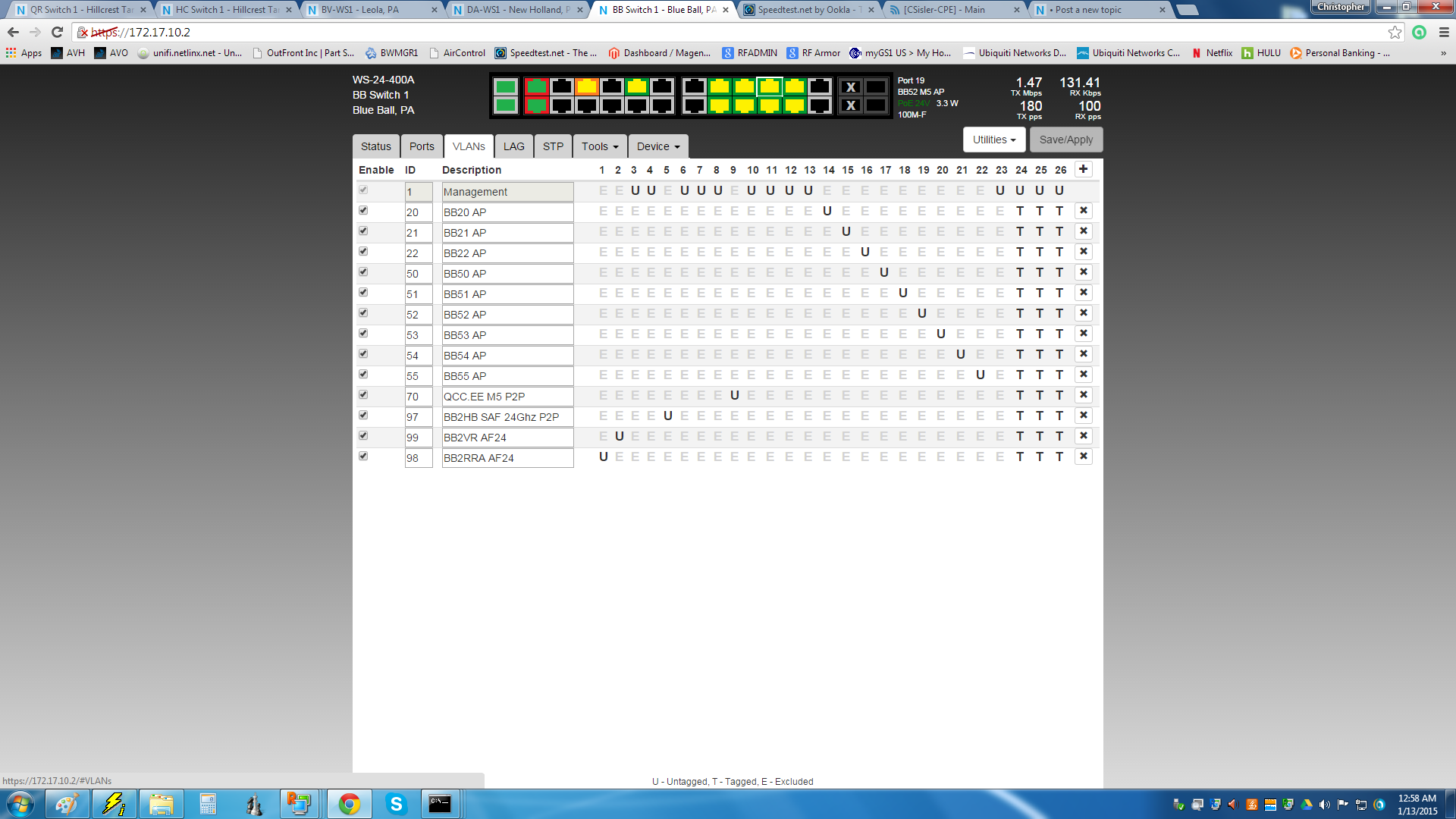

Also notice the tabs open to the left of my speed test, those are some of the switches/towers my home traffic also has to go through. Remember we create a STATIC LAG between our routers and the WS-24-400A in each tower then make each WISP Switch interface a VLAN to a virtual interface in the router.

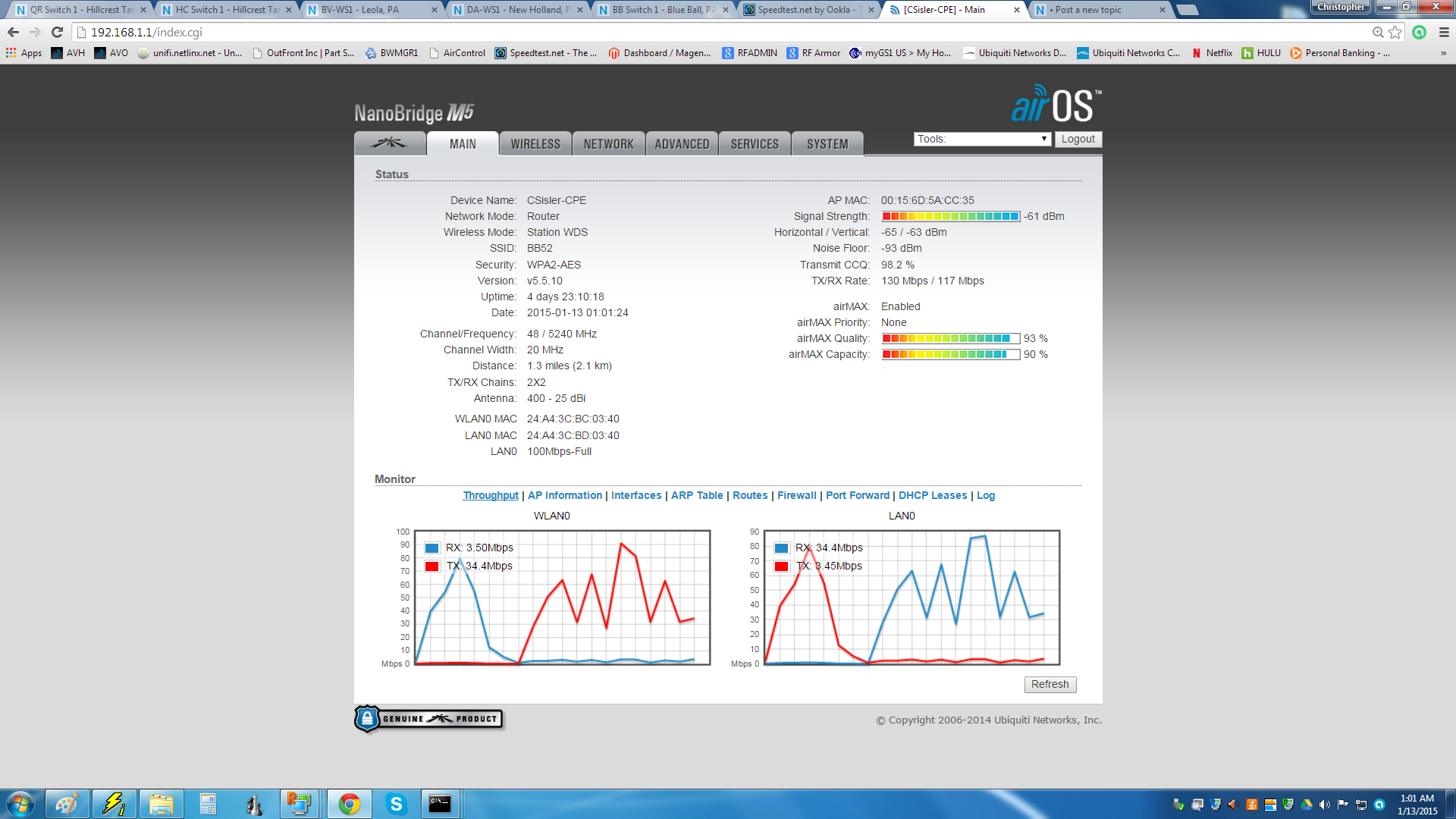

Here is a screen capture of my home speed test which is on a 20 MHz wide channel AP, a screen grab of my tower switch, and a screen grab of my home CPE.
We are running WISP Switches at every tower and they handle ALL tower traffic including AF back hauls. :hurray:
And all my radios even CPE radios use RF Armor. :thumbsup:
