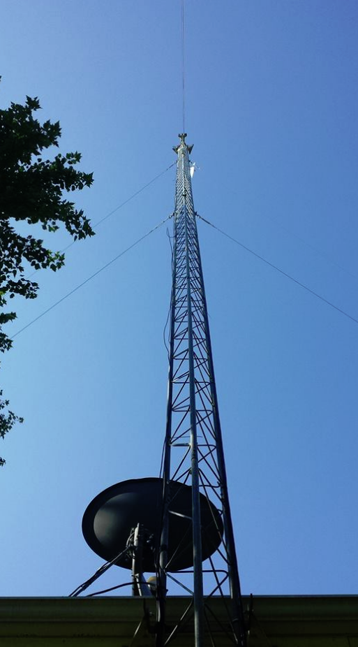

I have a 90ft rohn 25g tower. I started of small with just a 2.4 omni. I started to get many customers so I finally took the omni down, and instead installed 3, 120 deg sectors.
I have RF armor on all of them. I have them each at 10mhz channel width, separate channels.
I have had this up and running for almost 2 months. I've noticed the connections to the customers have not been the greatest, but seemed to work still. Someone else said I might have the sectors too close to each other and to move them vertically. I really would hate to do that because I need them all as high as possible.

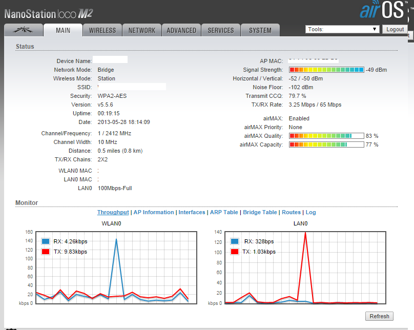

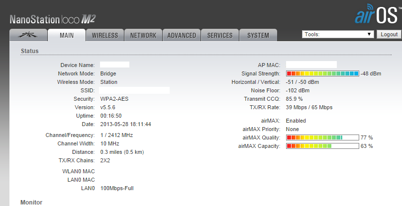

I look into her CPE and power levels are strong, but CCQ is high 70s, sometimes up to mid 80s.
The TX and RX rates fluctuate as well. Here are 2 screen shots.
Is this self interference? Local? Or just other noise?
