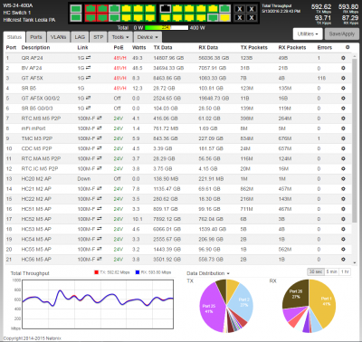

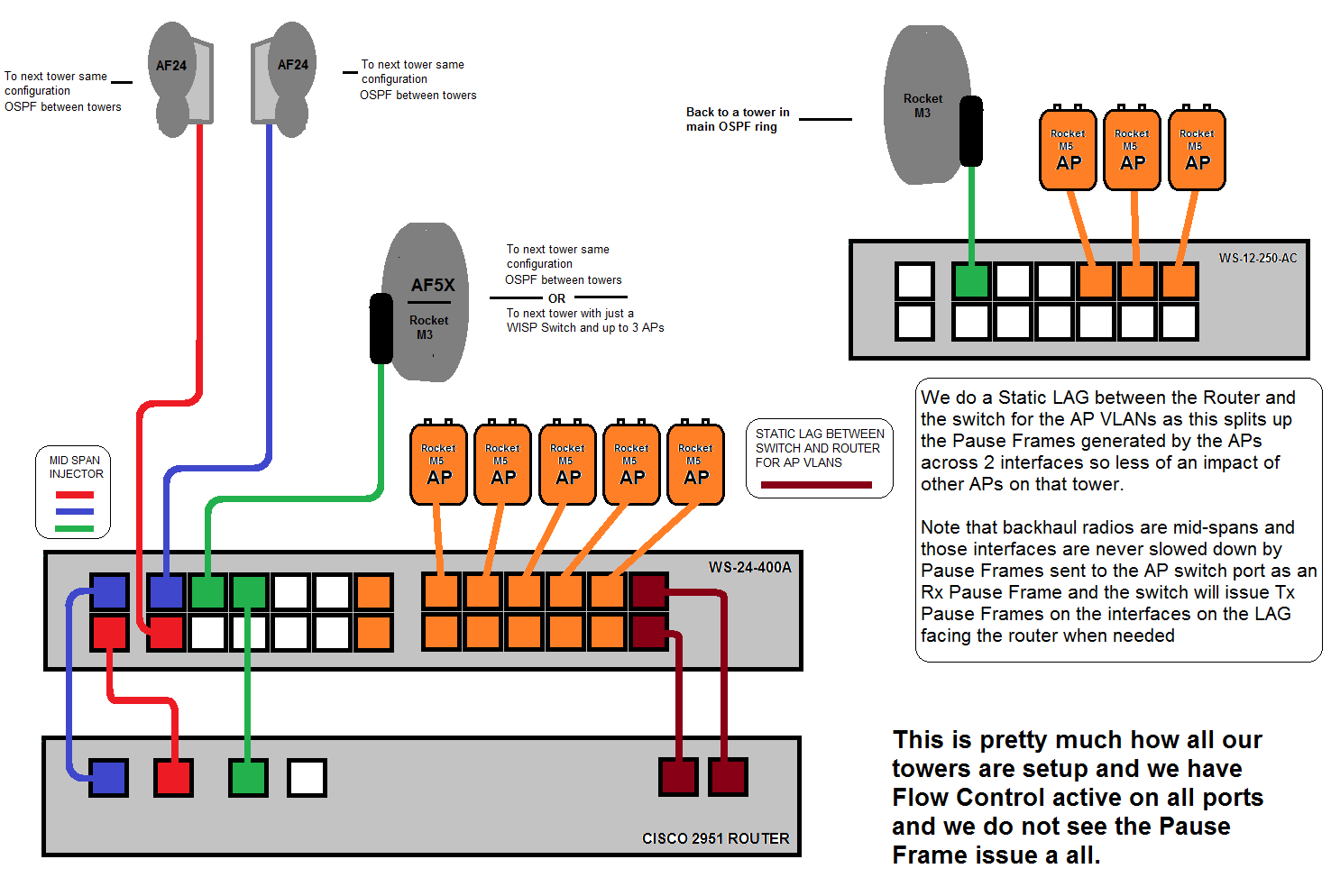

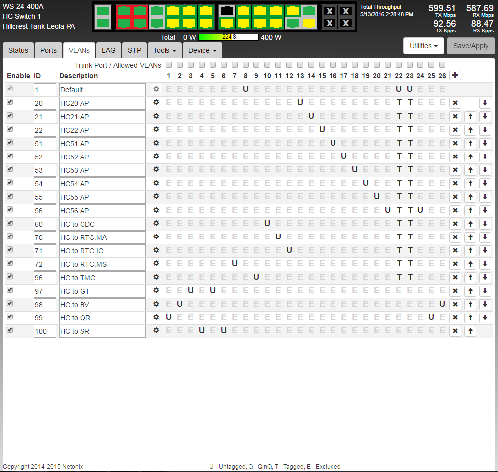

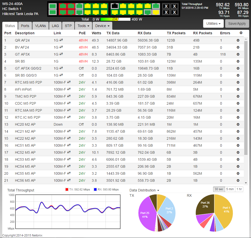

Fri May 13, 2016 2:20 pm
This is our typical tower setup and we have never seen the Pause Frame issue?
You will notice that Flow Control is turned on and ACTIVE as indicated by the 2 little arrows to the right of link speed.
You will also notice the dreaded CRC errors on the AFX radio - gerrrrr
No mater what we do we can not seem to get rid of them.
CRC errors will crop up on the AF24 ports if there is a heavy rain event and especially if the links drop out from rain.
We also see a lot CRCs on another tower with an AF24 with a Dragonwave 24GHz link that is 25 feet away at a 90 angle (not our Dragonwave Link). No matter what we do on that link/tower we can not get the CRCs to stop and they are consistent but the link does push 500 to 600 Mbps reliably with little to no packet loss so we just live with it.
You might also take note that Flow Control is NOT active on the MIMOSA B5 link on Port 4 even though we have it turned on in their UI and in the switch (their Flow Control no workie yet)
