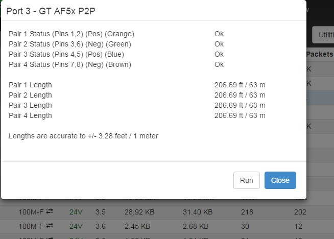

Running latest FW 1.3.8 - AF5X with 200' cable run. Per below, used 24VH, POE smart=off. Switch went bye bye Pirate4

24V and 24VH works perfectly with AFX radios.
Here is one of mine.
Run the tests outlined in Post #2 of this thread viewtopic.php?f=6&t=1259
See what damage is done then if need be for repair or warranty follow instructions in Post #1
