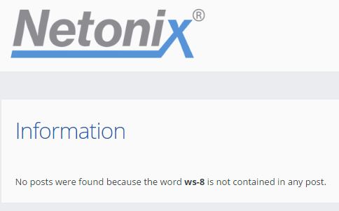

I used the advanced search by clicking on the hour glass and then adding the words I want to search for and by what author.
Obviously the answer would probably be by me so I selected me as the author and I think the words I used were: +Port +Watts
I did not search for WS-8-150-AC as it contains dashes and it messes with the search since "-" means do not find (read the advanced search help)

Makes sense, and I should have tried that.
